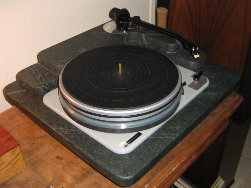

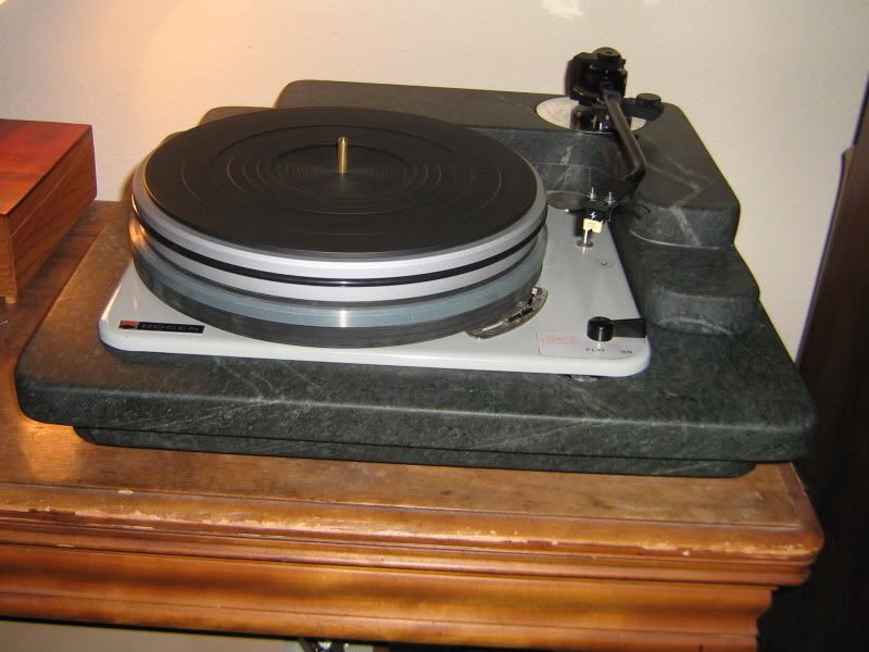

I started this project about a year and a half ago, and then never finished it. Well I got inspired, and have just tonight finished the build.
The deck started life as a light steel platter deck, and now has been converted to a heavy double platter stacker deck, with heavy platter bearing and a custom bearing brace to support the load.. The platters weigh in at about 18lbs for the pair.
I just finished this at 9pm tonight. Back sore, arms sore, coughing from dust. I'm going to bed. Tomorrow will be listening day - well all weekend, actually.
This is my 1963 Bogen-Presto BP51 (Lenco B51) - aka, the BP51HPmod_stacker:
IMG_1161JPG.jpg~original
IMG_1166JPG.jpg~original
IMG_1168JPG.jpg~original
IMG_1162JPG.jpg~original

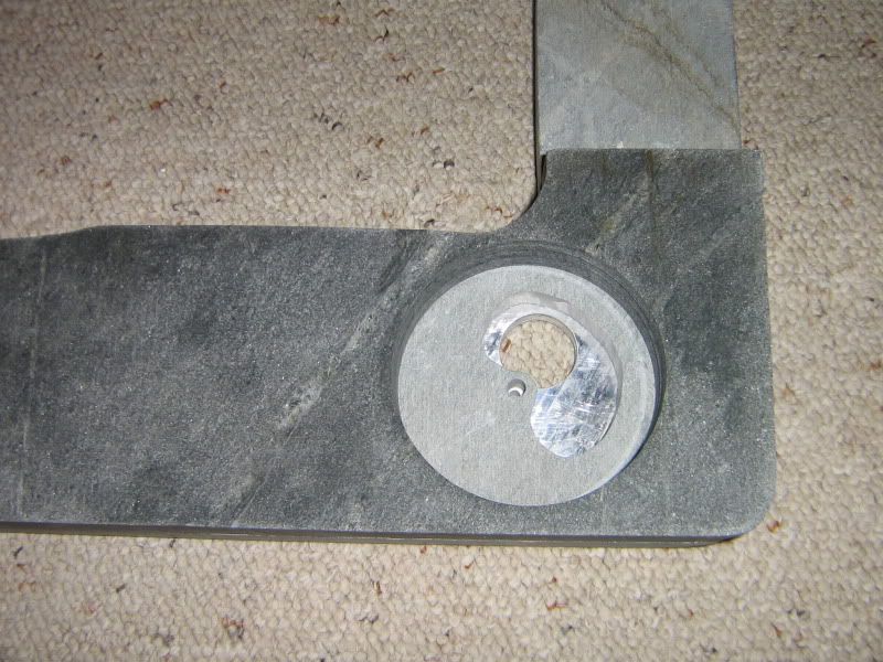

The armboard is a separate entity, removable from the main plinth deck. It is two stacked sections of soapstone, and built with high adjustability in mind.
IMG_1144JPG.jpg~original
The top layer is cut in and routed out to 1/2" deep. There is a sweeping adjustment crescent that is also cut through to the second layer of the arm board.
1/2" aluminum disc for the armboard; center drilled for circular adjustability, in place:
IMG_1145JPG.jpg~original

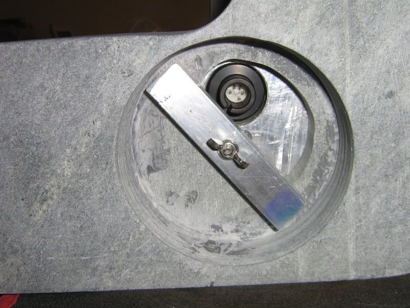

Armboard base underside, looking back towards the al. disc. I've since cut a passage through for an RCA jack panel:
IMG_1149.jpg~original
Brace for aluminum disc/arm in underside of armboard.:
IMG_1156.jpg~original

This is the underside of the plinth, with a bearing brace in place.
The plinth is two layers of soapstone. The top layer is solid. The bottom is sections from matching rem pieces, cut to fit, and laminated onto the solid top plate piece. I've left the rear open for ventilation, and tonearm arrangement changes.
The feet are 3" hole-saw cut-out plugs. I cut their bases to 1/2" deep into the plinth, and routed out to the same depth.

Beautiful craftsmanship! Is soapstone a difficult to work with?
thank you, Doug!
Soapstone is quite easy to work with, perhaps even easier than some hardwoods. I did all of this with some basic power tools, no "professional/industrial" gear.
The most pro-like tool that I used is a wet tile saw, and a router; the rest were circular saws (diamond blade), jig saw, angle grinder, portable drill, drill press (small bench top type), lots of squares and clamps. Ohhh, and a ton of JB-Weld epoxy.
