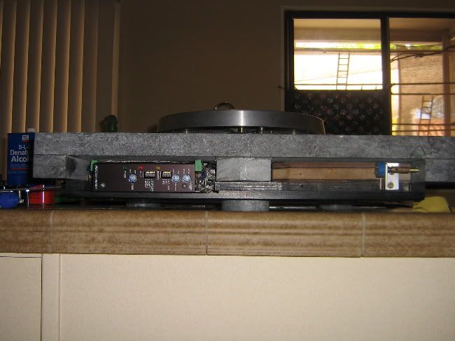

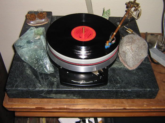

    Let me start with this image of the finished TT as a hook; Then, I'll start over with the build from the start.
    [​IMG]
    I've had a few postings about this deck in various threads, here at AK; but I've not started a feature thread about it yet. A few of you Lencophiles have likely already seen this buildup over at LH. There will not be a pop quiz following the presentation.
    So without further adieus and ramblings,....
    This is my Presto Recording Corporation - Pirouette T18DC_mod, c. 1955; reborn 2009/2010; An idler drive TT for the 21st century.
    It started as a 3-speed, three wheel idler drive TT, circa 1955; and is of the last of the true vintage pre-Bogen era Prestos.
    [​IMG]
    It bears the mark of his noodliness, the Flying Spaghetti Monster:
    [​IMG]
    That mark, ^^, made it a holy divine piece, and I endeavored to restore it to its former glory - little did I realize that it was in no mood for any such restoration; It was going to demand a far more intensive effort! It demanded a complete drive-line redesign to drag it out of mid-20th century mono era, and into the second decade of the 21st century.

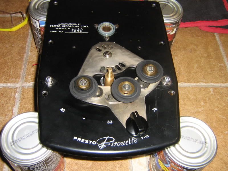

    The first thing to do was look under the skirt to see what I was in store for.
    [​IMG]
    OK,... So it had three idler wheels,... interesting.
    What drove these wheels?

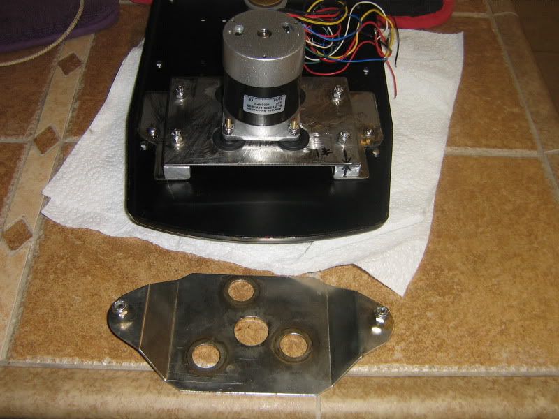

    The driver has three hall sensors around a 360º circumference. They monitor the speed of the motor, and keep it locked at an unwavering dead-to-speed locked RPM. It does not slightly wander off speed. I can carry speeds from a zero-stop to hundreds of RPM at the platter.

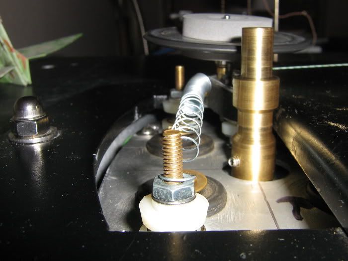

    A new motor mounting plate is built, and new motor mount suspension grommets are installed at each point.
    [​IMG]
    [​IMG]
    A new mounting achieved:
    [​IMG]
    [​IMG]
    [​IMG]
    New stainless steel vs. old mount:
    [​IMG]

    Result: Newly realized driveline noise; AND, worse -- A realization that the original geometry of the three wheel design favored the newly developed 33 and 45rpm speeds, and only included the 78rpm speed as a nice added speed, as it was still so close to that era. The deck was fundamentally flawed and noisy if you tried to adjust the motor tensioning to accommodate all three speeds in a single adjustment.
    The design is best described as a power take up from a rotating platter and its interface with the wheels and capstan. The power uptake regime was designed to transfer the capstan -> wheel -> platter at approximately two positions; 5 o'clock and 7 o'clock, with a crucial center point line being marked by the 6 o'clock to 12 o'clock center line, from bearing to capstan. Look at the image above, and mentally draw a line between the bearing center and the 33prm graphic on the top plate, with the bottom of that line being 6 o'clock.
    The 33/45 rpm speeds power take-up were on the 5 o'clock side of the 6 o'clock line, and the 78 rpm wheel was at the 7 o'clock mark - you can see that in the last image, above.
    At the 5 o'clock position, the wheels are captured by the downhill motion of the platter, and driven into the capstan, in an ideal, forced-into-compliance motion. The 78rpm wheel, however, was on the uphill swing of the platter, past 6 o'clock, and, the only way to properly engage that wheel was to adjust for it; But by adjusting for it, 33 and 45 rpms became noisy. A vicious cycle ensued.
    By adjusting to 33/45, you barely engaged the 78 wheel. Ideally it would need a spring to engage the 78rpm wheel, but its design precluded any spring, as such force would only pull the wheel further away. Believe me, I looked at many options.
    Presto designed this deck with two wheels too many.
    The drive-line is flawed in that regard, and it wasn't until I'd dropped a few hundred dollars into the project that I realized the flaw; it was too deeply buried to be able to detect in the early stages. It would be a decent enough 33/45 deck, or a fine 78rpm deck; just not a universal three speed deck.

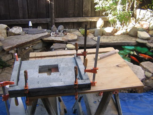

    In the end, i also needed to develop a plinth to know if it were to work. So a plywood mockup was constructed. I rigged up a few toe-nailed templates, jigs, and found that it was plausible that this would fit.
    So, while still developing the basics of the new driveline, I started building the plinth for it as well. This one was going to be of soapstone, my first effort in soapstone. Why not breach more new ground in this process?
    A remnant slab is procured:
    [​IMG]
    Cutting underway, and the first motor mount fitting:
    [​IMG]
    First fitting of top plate and new driveline mechanism:
    [​IMG]
    You can see the apprx. platter radius, traced in pencil - This is still early dry-fitting:

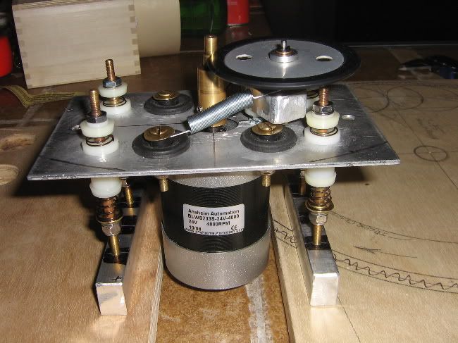

    The motor mount, drive-line mechanism; an in-depth study in DIY'ing a TT drive-line,...

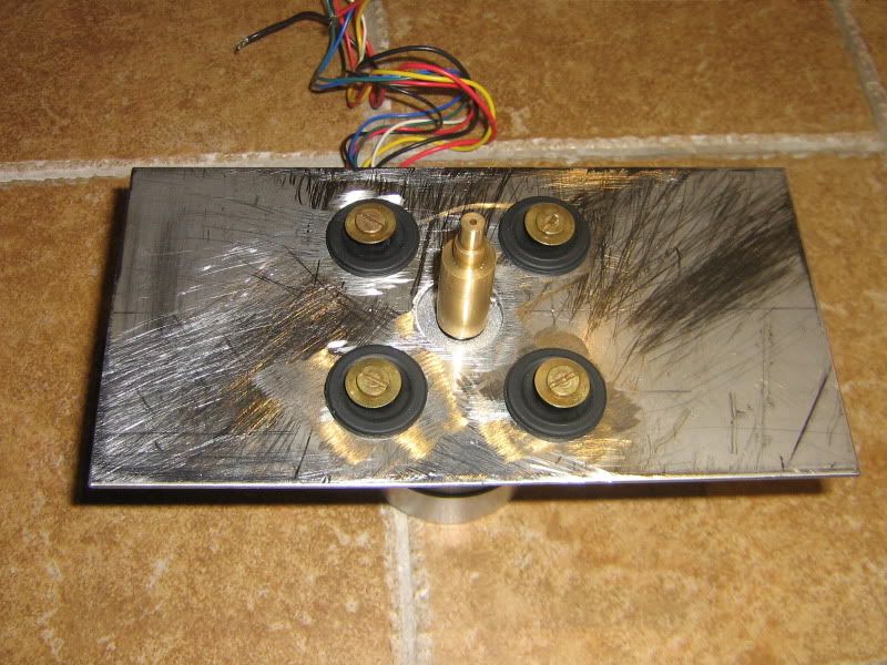

    The motor plate suspension struts:
    [​IMG]
    These struts are K&S Engineering precision brass tubing, brass screws, nylon spacers and washers, and Lenco motor springs.
    The nylon washers offer a nearly friction-free motion on the precision brass tubing, allowing the motor springs to freely absorb excess energy that escapes past the rubber motor mounting grommets.
    Struts, whole assembly, and exploded:
    [​IMG]
    struts side profile, motor mount plate added:
    [​IMG]
    motor mount assembly, from a higher profile:
    [​IMG]
    motor mount assembly, mounted to finished CLD base plate. The motor is no longer attached to the plinth or to the top plate. Its now mounted to a suspended base plate that is attached to the plinth from below, by four rubber well nuts. This is to isolate the motor from the plinth, for vibration damping.
    [​IMG]

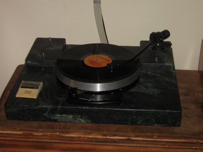

    I decided to abandon the second layer, the armboard of this design, as the deck was becoming unmovable with the load of the motor mount CLD base.
    So, I'd already cut the top deck of the plinth, with the notion that the armboard would cover the motor mount cut-out. I had to cover that hole, and, as a bonus, I wanted to create a better shielding of the motor from the cartridge pickup. So I got some 1/4" aluminum plate, and cut a shield that profiled the deck, and platter. The only point that it came wider than the top plate/platter profile was to cover the motor mount hole, and I brought the shielding in to a minimized cut-out, to maximize the shielding.
    [​IMG]
    The new profile with the fitted shield:
    [​IMG]
    Side profile of new motor mount, new painted shield, and new custom capstan, hour-glass cut to profile the platter - its that tight under there!
    [​IMG]
    Back under the skirt for a bit:
    This is the bearing for the platter. I've braced it in two directions. There is an o-ring of aluminum that pulls the top plate and bearing housing down onto the stone top deck. There is also an aluminum bar that carries the end of the bearing housing, and secures the end cap, in an upward force. The o-ring pulls down, the bar pushes up.
    [​IMG]
    [​IMG]
    Plinth, exploded view. The motor CLD base fits below the top deck. Armboards bolt to the top deck.
    [​IMG]
    Top plate and shield mounted to top deck:
    [​IMG]
    Armboard routing detail:
    [​IMG]
    [​IMG]

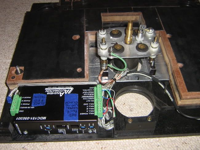

    Rear of deck, unfinished, with driver and speed control pot shown:
    [​IMG]
    [​IMG]
    Rear of deck, finished:
    [​IMG]

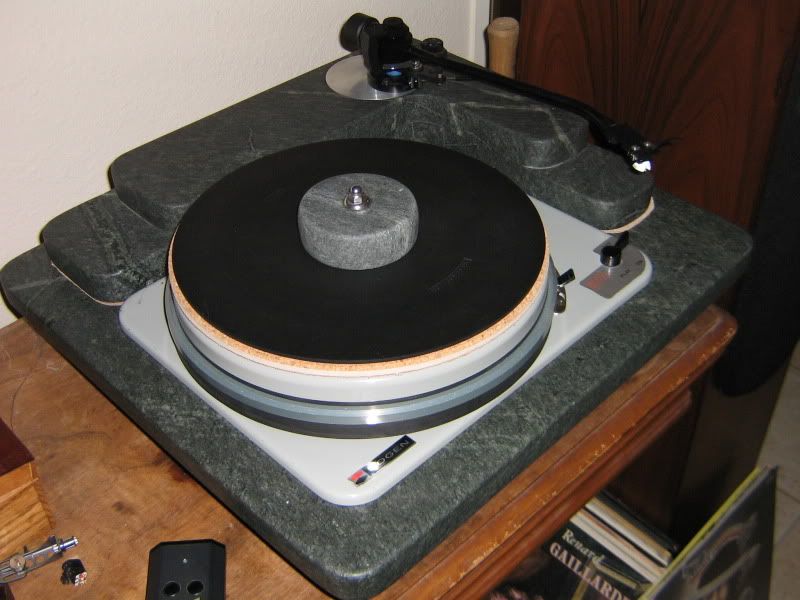

    You can see the finished armboard on the left. The blue connector is a Neutrik SpeakOn connector, capable of 250vdc and 50 amps. Its a solid twist-lock connector.
    Its first spinning of a stereo record. it was originally built during, and rigged for monaural. It wasn't until my effort that it became a stereo deck.
    [​IMG]
    **The only post-redesign drive-line modification that I've done was to take the motor CLD plate off, dismount the motor, and reverse the wheel take-up side, by turning the motor mount plate 180º. The original mounting side was somewhat particular, and lacked torque.
    By swapping the take-up location from 10 o'clock, to two o'clock, I upped the torque by multiple-fold, two or three times the torque. In fact, it now has so much torque, that it grabbed, twisted and bruised a finger, causing stiffness and swelling - this deck is a torque monster.

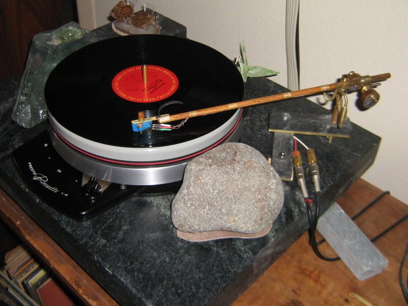

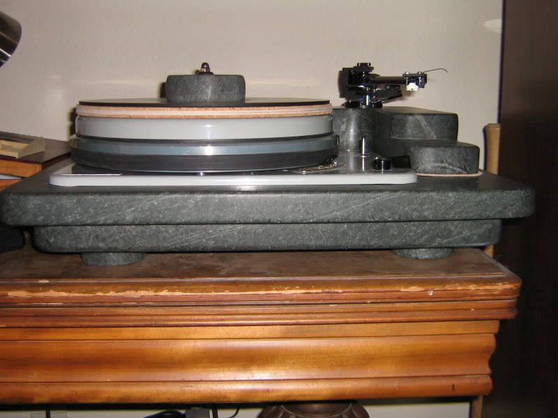

    **UPDATE #1: I added a diy'd hardened steel thrust plate (from a construction knife blade) to the platter spindle bearing for a major upgrade, and added depth of blackness.
    *** UPDATE #2: I replaced the spindle bearing bushing sleeves with new ones, 2011-08-09
    I've since changed the modern Jelco arm out. I built a DIY unipivot tonearm that I call the RatsPaw. I started a feature thread about that arm here at AK, several weeks ago. I also began experimenting with stacked platters with this deck. I'm using a platter from a recent Bogen project, but intend to replace it with a 1.5" thick piece of Delrin/Acetal, as a platter extension, in future times.
    This is the Presto deck, with stacked platters, with the RatsPaw mounted to it:
    [​IMG]
    [​IMG]
    I call her: Presto Pirouette T18DC_mod, an idler drive for the 21st century.

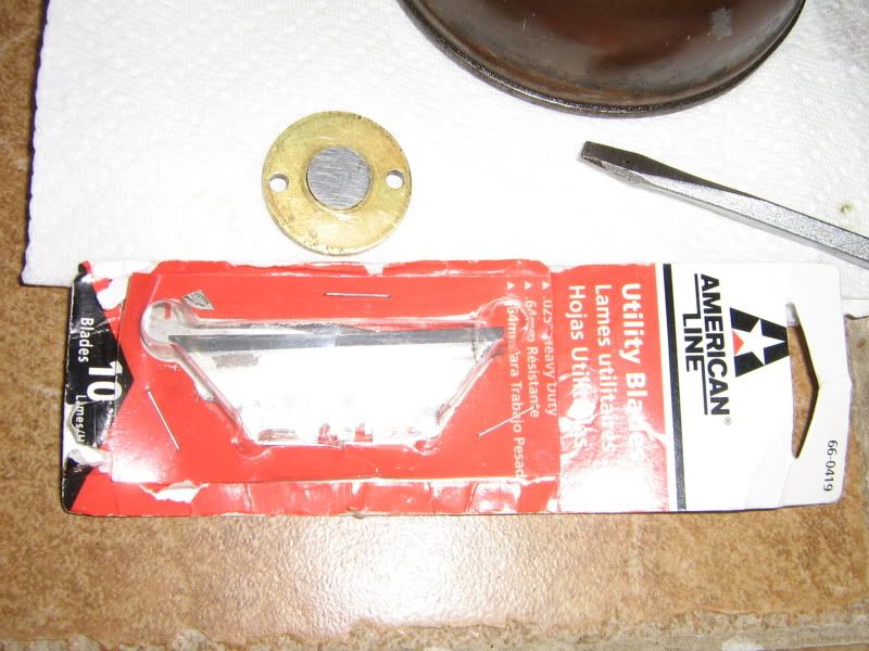

    To preface this post,... I've been experiencing a developing motor noise, a whirring that is audible in an ambient sense, but not translated to speakers. It was audible from a couple of feet from the deck; buried in the music, but still annoying.
    A new thrust pad made from a construction knife blade. It is .025" thick, or, .64mm thick, and of hardened steel. I took an angle grinder and just kept grinding away until I had a small circular disc. I epoxied it to the original thrust pad with four small dots of JB-Weld epoxy to ensure that it would not become loose and noisy.
    The difference in the way the platter felt was immediate.
    I did this because I've been trying to sort out some motor noise and vibrations. I also removed the set screws from the capstan, as they were contributing to the vibrations substantially. I'd installed two of them, thinking that would be a better balance than just one. So, I shimmed the capstan onto the motor shaft with some thin teflon tape, and the vibrations went away (read: rumble). Now I just have an apparent motor noise, a whirring, that is only audible in an ambient sense, and does not translate to speakers; a minor annoyance, but still something that I'm trying to work through without buying a new motor (not really expensive, around $65, but still,...)
    Though not apparent in the picture, the new thrust plate sits on a raised pad (the old thrust point), that is the same diameter as the new plate, so its obscured.
    At any rate, the new thrust pad, and raw materials:
    [​IMG]
    Result:
    WOW! *I spun this up to really high-speed for quite a while yesterday (15 minutes at 200ish rpm platter speed), and then let it run at normal speed overnight - motor noise gone. Platter rotation is smooth as silk. Major upgrade! I'm really blown away, actually, and thrilled with the results.
    I wonder if this deck had been missing some sort of thrust pad all along, or if the original design had intended to have the ball turning on the brass/bronze end? The ball, it seems, had finally dug in deeply enough into the original thrust pad that it was causing the motor to go noisy. Such an easy solve for such an aggravating problem! (it seems,... keeps fingers crossed)

    OK,... I fitted new spindle bearing bushing sleeves today.
    On a whim, I was over at Lowes, and mosied on over to the hardware section, where I found sintered bronze bushings of the proper inner and outer diameter, 1/2"o.d. x 5/8"o.d., but they were too long at 1 1/8". I needed two at 3/4" if I were to match the "originals".
    I wanted to make the top bushing longer than original for better support for my stacked platter finish to this deck, as the top bushing had a devloping case of lateralis; so i wanted to gain more support on the upper bushing.
    So, I bought them in hopes that I could cut one of them down.
    I was able to cut the bushing with an angle grinder and cut-off blade, perfectly, without burning the bushing.
    I pressed the old ones out using a vise in my garage, with a slightly smaller ratchet socket. I backed the bearing housing with a piece of PVC irrigation pipe to prevent damaging it with the vise, and to have a cylinder to press the old bushings out into. This worked perfectly and quickly.
    I oiled the sleeve, and pressed in a whole 1.125" bushing into the top of the housing. I then cut the lower bushing to fit, leaving a slight gap between bushings, of about 1/4", whereas the original pairing had a 5/8" gap between them. I wanted to eliminate that gap, yet retain a bit of expansion room between the bushings. So I left about a 1/4" gap between them.
    I pressed the new bushings in similarly to how I removed them, with my bench vise and socket.
    I tried fitting the newly bushed bearing back onto the spindle, and it went on very snugly, but wouldn't really rotate freely. They had distorted slightly from the pressings, so I took a 1/2" drill bit, and hand twisted it back through the new bushings to align them, and ream them.
    So I then over-oiled the spindle and bearing, and held the bearing by hand and rotated it slowly until it felt more free. At that point, I started to spin the platter, and it spun quite freely, but had a friction noise. It fit nicely and spun quite freely. So I hooked it all back up, and ran the motor to it, and turned the speed up to hundred of RPM at the platter for a half hour. After that time, the bearing went quiet, and spins freely and silently now.
    The platter rocking has gone. Its really nice, straight and rigid now. I'm calling it a success.
    Somehow, this all happened from the parts drawers at my local Lowes store - I'd never have guessed it possible.

    Well, I had started a second soapstone plinth project, just after I finished this Presto. That second plinth was for a Bogen-Presto B51 that I intended to convert to a heavy platter deck with a Lenco platter and bearing. I quickly got going on it, and then, got to enjoying and tweaking this Presto, and the second one got pushed aside, under a console player - (a great toe breaker under there!).
    As time wore on, I decided to experiment with a stacked platter setup, as some folk were really excited about the isolation that a second platter offered. I had a second platter, and wanted to try it out. To do so meant that the Jelco was no longer close to being high enough. So I dismounted it from the plinth top (two screws), and brought in the 'Paw from the side, because I was able to elevate it higher, and more easily.
    Well, before I knew it, I really was drawn to the 'Paw, and the way that it looked. It gave the deck a whole older appearance than the Jelco did, like a 40's or earlier look. but, more than that, the 'Paw is an amazing arm. My wife loves it. She'll ask me to hook that deck up when she wants to spin records, if the Jelco is hooked up.
    The 'Paw is an arm for a tall platter table, not a shorty, like a Lenco. The Presto is a tall deck, and then I added a second platter and barrier layers. This made this Presto a natural for the 'Paw. And with an off the scale high WAF thing going on,....
    sidetracked,....
    So, I kept looking at the stalled B51 project, and the only thing that was keeping it from being finished was the fact that I didn't have an arm for it, and, with the economy being tight, I couldn't rationalize spending on a 12" arm, when I already had the Jelco taking up shelf space. So I built an articulating brass and soapstone mounting base-arm for the 'Paw to mount it to the Presto. This freed up the Jelco to go onto a much more modern looking deck, the Bogen-Presto BP51HP_mod deck.
    The new 180lb base for the Jelco:
    [​IMG]
    [​IMG]
    Its shared (strained) table with the Presto T18DC:
    [​IMG]
    Some rough calcs had this pair ranging somewhere around 350lbs; table strain.
    At any rate,... there it is.
