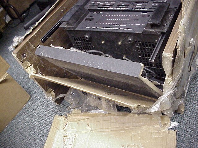

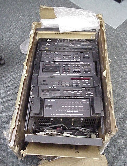

Full Rack of SAE Gear  SAE Rack
Some cardboard around the outside by itself is NOT enough protection.

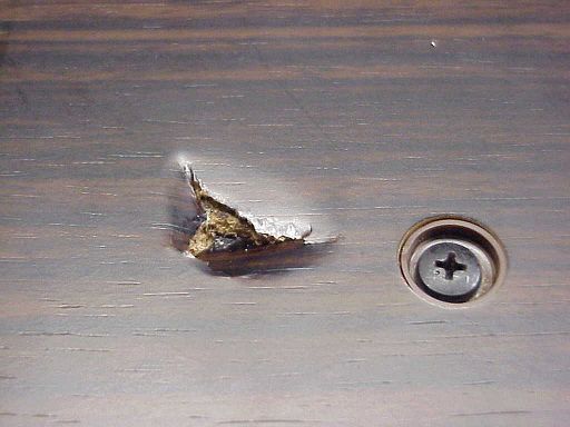

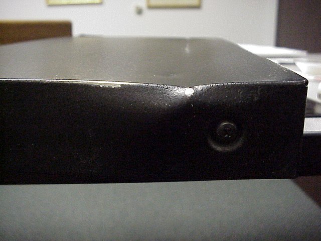

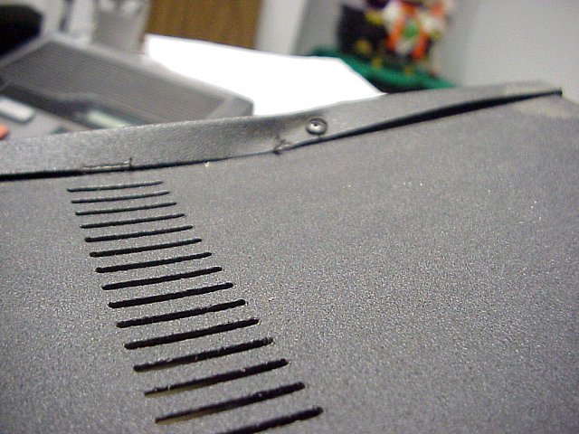

DBX 120   DBX200   SAE P101
Here is a DBX 120, a DBX 200 and a SAE P101. All damaged during shipping due to inadequate packing.

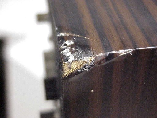

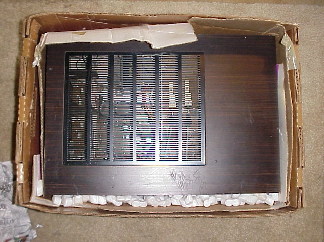

too small a box Yamaha CR640 Yamaha CR640
Once again, box was to small and not enough packing, so you get a Yamaha that's crushed & punctured.

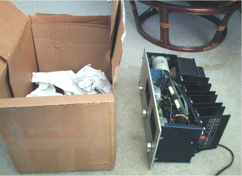

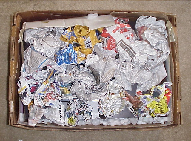

Same old story, box is to small for the unit
One layer of crumpled newspaper and a hand full of peanuts is not adequate.

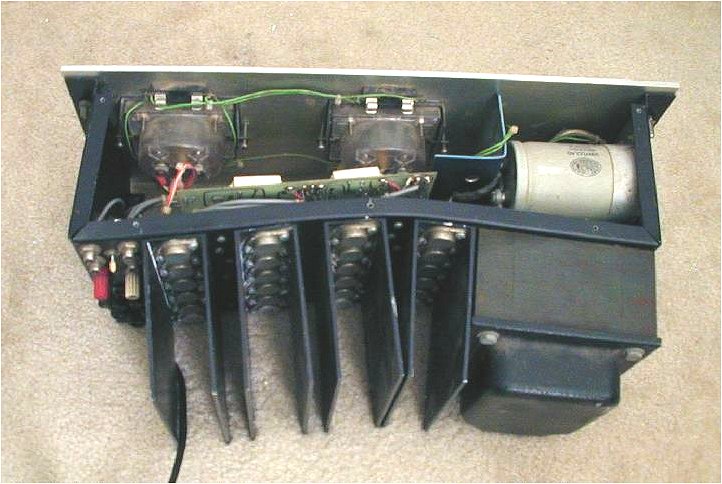

Here is a Phase Linear 700 a friend received.
This seems to be a common story among audio guys.
Yet another box to small and almost no packing material.
