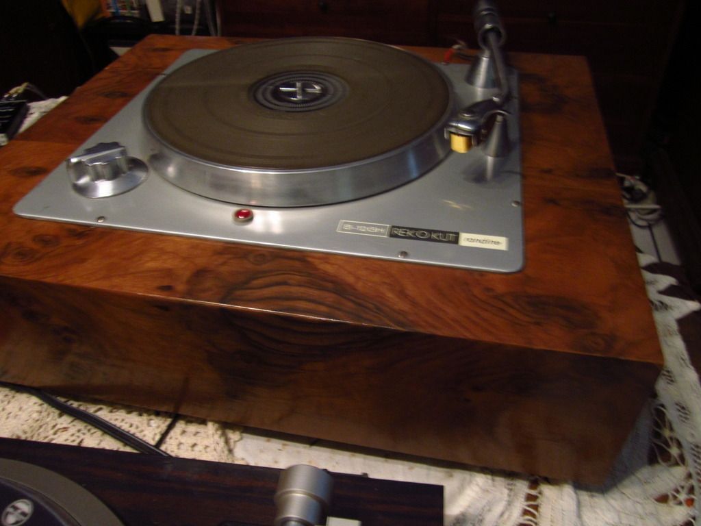

First off I will never admit to being very good with wood and don't have any carpentry tools, other than I used a table saw, and some clamps and glue, and I do have an old router that I purchased at a thrift store. I purchased the veneer off ebay and used contact cement as I simply wanted to get the table up, pretty much built it and playing in two days. I used a water base clear coat on the veneer same stuff I used on some hard wood flooring, dries quick and I was told harder finish than that of petroleum based varnishes. Hey I even matched the grain! I really didn't know what to expect out of these old tables, and didn't think they were anything in the magnitude of a Garrard so I wanted to keep it simple and cost effective. In retrospect some day I will probably get a good arm and build another plinth and now that I can use this I can take my time on a better one. I can't say I am disappointed in the performance of the table, I don't find it noisy at all, and on my old mono micro grooves it sound pretty good.
I should add I really enjoyed doing it but it is a bit frustrating not having access to a real wood shop, with all the right tools, and really working with wood seems like something that you need to take your time with and not get in a hurry.
I really like the veneer the OP picked out, it takes burl to another level.:thmbsp:
That's a beautiful job. Congratulations to both of you.

Seriously, analog addict, you and your client might want to reconsider this. I moved my ROK L-34 from a box plinth to a massive layered one, and the difference in performance was not minor (although it weighs a ton!). It could still be veneered to look pretty.
I hope your expensive, heavy turntable is not sitting on what looks like a $4.99 plastic wobbly thrift store stand!
