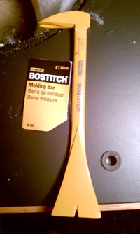

I know but my claw hammer won't fit in there. I might have a smaller one at the office. I'm still afraid I'll break it.
Then use a smaller pry bar. Take your time and pry gently and chances are it'll come out in one piece. Don't fret if it does break though. Chances are you're going to have to fashion a new backing board anyways to accomodate the much larger caps.
Try a putty knife or similar with a thin, flexible blade. Work it under very gently and carefully. This has worked for me to remove crossover boards and JBL foilcals with minimal damage.

So I went to Lowe's today and bought a Crossover Remover Tool. They don't know any better and call it something else
which just seems to fit in there fine

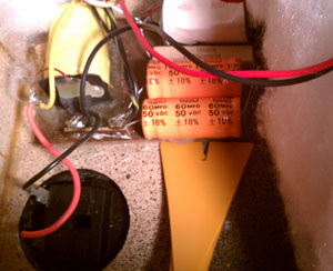

As it turns out, there wasn't a lot of glue on the back of the board

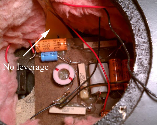

Now to the tweeter crossover. It's a much smaller area with a bigger board and my new Crossover Removal Tool can't get under any edges, thus so far haven't budged it....
Figuring it out
Still working on getting the upper crossover out. In the meantime....

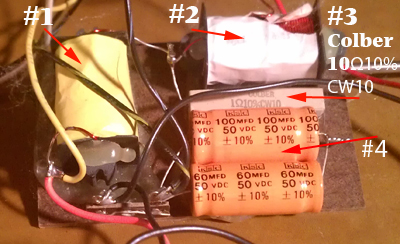

Here's a photo of the lower crossover. (Remember this is new to me.) Am I right that #3 and #4 are the caps? What are #1 and #2?
EDIT: Only #4 are the caps... see post 22 below

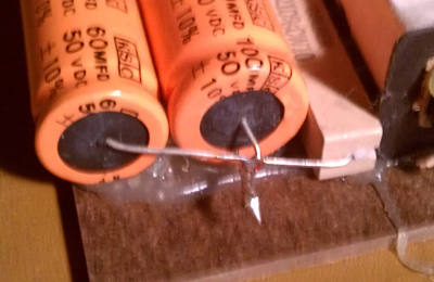

Here's the two ends of the caps.... on one end all 3 are joined, and on the other end the square one goes to #1 & #2 while caps #4 go to the board
Can someone explain the electronics of this to me?
