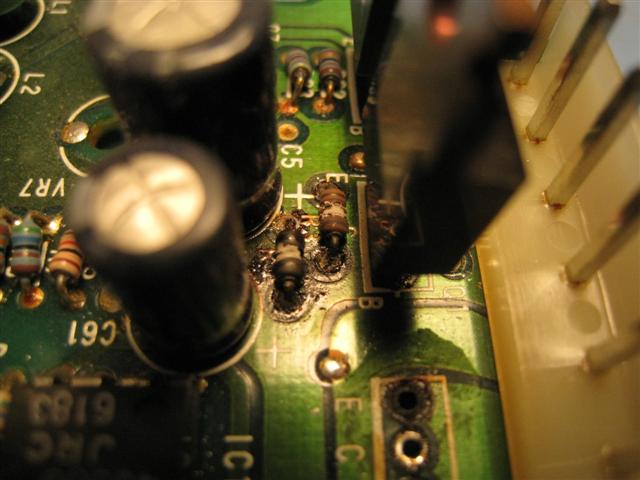

don't want to hi-jack this one, but how do you keep from being "that guy"? Burning traces, solder-blobiness, etc.
Basically just Give-A-Sh!7 is what it comes down to most, and I think is what the biggest gaps with the hacks seems to be. I've gotten stuff looking almost that bad from guys who have been slinging solder for years, they just never bothered to figure it out or care.
There's loads of 'how to solder' sites on the web... few keys to it like the importance of CLEAN the RIGHT TEMP AND TIMING (neither too hot nor too cold) and accordingly good equipment comes into it (temp controlled makes things SO much easier). I'm sure I'm no 'uber-master' myself but I always strive to have my joints look as good or better than the factory at least... If I get a joint that doesn't, I'll clean it up and start over...
What this guy did wrong? Well if you WANTED to make a mess like this, you'd follow these tips:
  • Don't give it a good inspection before starting - for instance especially don't clean up the slag from burned traces from original failure before re-soldering, and definitely don't look at anything other than the big burned part that obviously caught fire - you'll just be creating more work for yourself if you start getting fussy!
  • Don't clean the old component leads either, that would take time! OK but it might make stuff hard to flow so...
  • Just blob the hell out of everythign with solder when it isn't flowing well. More is BETTER! Start melting the solder first - don't preheat the joint, just melt some solder down on 'em, that'll work! When that doesn't work...
  • Just keep heating the stuff up! Maybe sooner or later it'll flow!
  • Only solder the joints for the parts you're replacing. Definitely don't bother looking for other component joints that might have been burned up by the failure or your bad soldering technique. As long as the parts not falling off the board, it's probably OK!
  • Don't bother to give a detailed inspection afterwards - if it's ugly just chop some globs off with cutters. It'll probably work! Close enough I say! Hey it's only KILOVOLT supply for a CRT flowing in this circuit... that much juice will just power through a bad connection I'm sure! The more power the less important the details are!
I think "the right temp" is the part that I haven't gotten yet... and it looks like you have to plunk down $40-$100 to get that control.

Update:
Looks like we found the problem that the PO didn't (or ignored...) classic torched emitter & collector resistors... He obviously just replaced the most burned BJT without fixing these... Also suspect there might be another bad BJT that he ignored because it wasn't actually on fire... more testing to be done...
How do you MISS this!??

I was right by the way... one driving BJT of a stacked pair went bad and the driven one was the one with the visible meltdown. So he put it back together with only one of them replaced, and dint replace any of those resistors... then it goes right back into meltdown-mode when you power it up.
Amazingly the replaced one still tests good... maybe he was just not-retarded enough to realize something was still wrong and instead of leaving it on until more damage was done, must have shut it off and given up.
Naaaww... probably I'm giving him too much credit. More likely it went into runaway until it blew a fuse and that's when he gave up.
Have some of the parts for the fix but still waiting on a few more before I can get this puppy back on the bench... Can't wait till I have too look into why the horizontal sweep seems to be hinky... probably some other disaster i haven't noticed yet...
