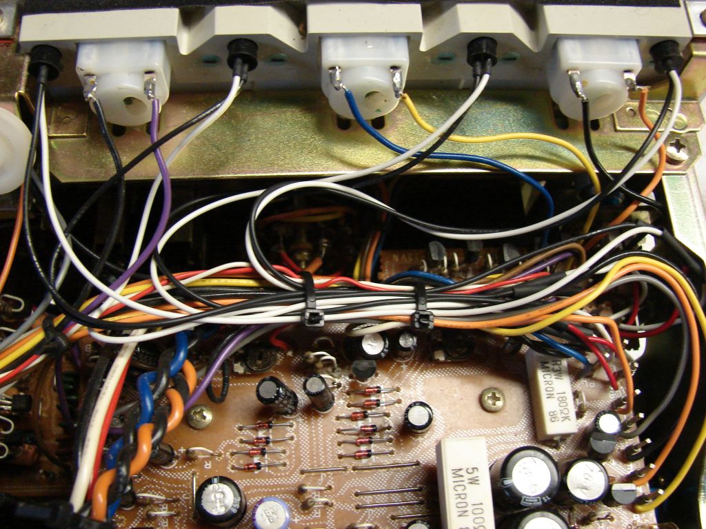

Next I relamped it with 5 lamps purchased from AKer Dgwojo.

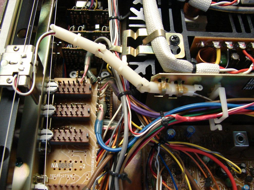

Here's the dial pointer lamp, note where I spliced it between the black tiewrap and the white wire holder thingy.
I also adjusted the idle current for both channels. This was by far the easiest gear I've every adjusted. In the above picture, you put your meter between the yellow wire and TP0 next to it. On the other end of that board is a pot, adjust for 10mv. The other channel is identical except the wire is brown instead of yellow.

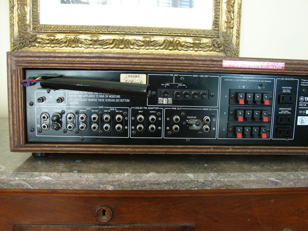

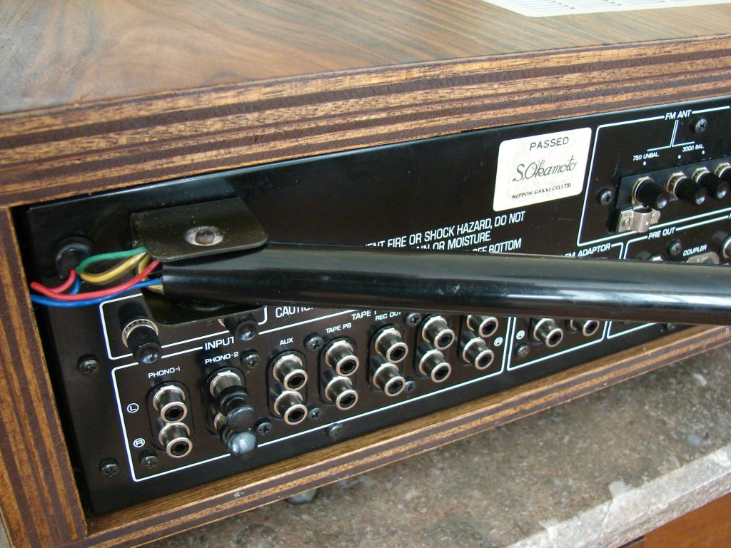

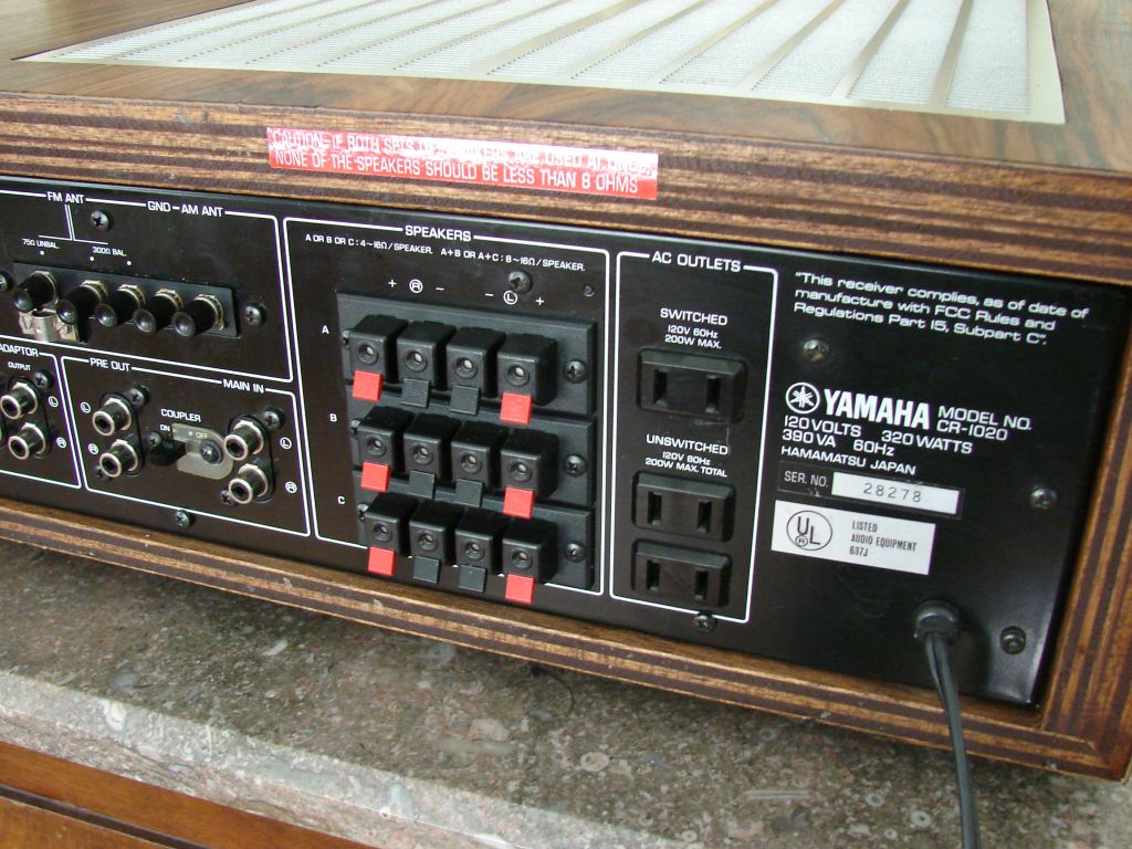

Here are some rear end shots

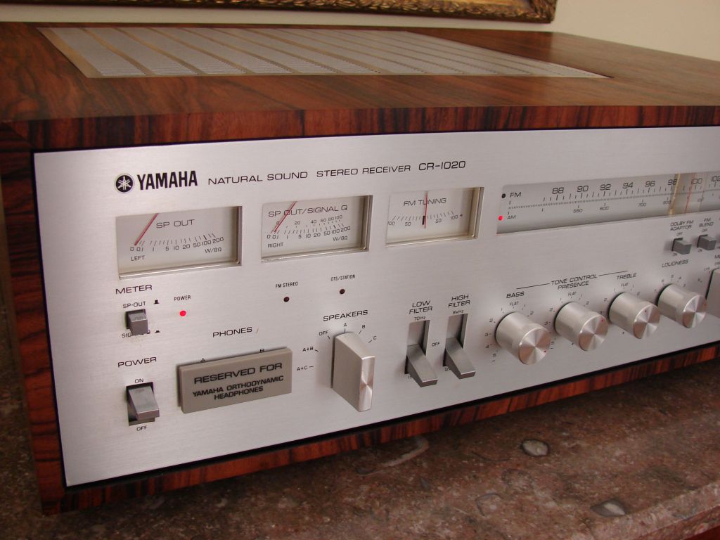

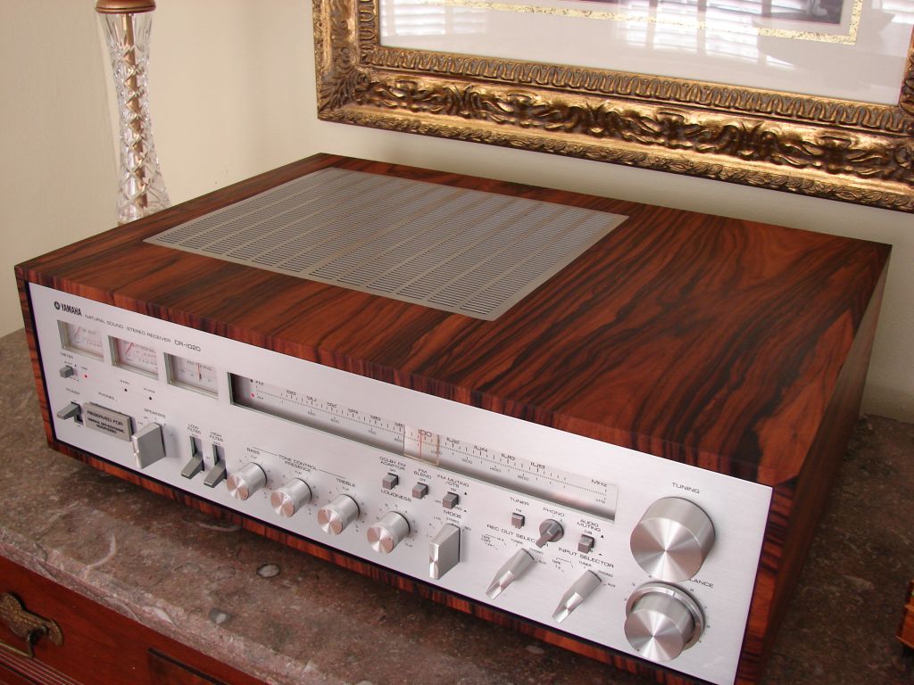

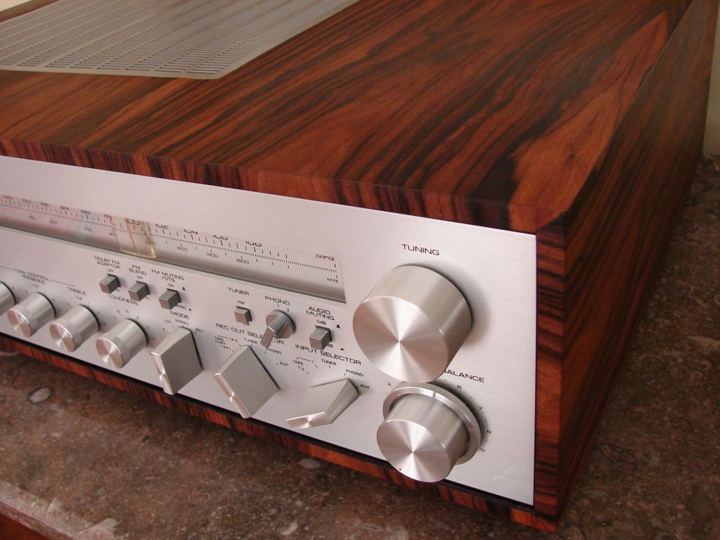

Finally, the Yamaha Pron view. Gary outdid himself with the veneer job, and I followed up with three coats of Watco Danish Oil.
Again, a big specialidiot special thanks to ejfud for the incredibly beautiful job he did with the case. This is a receiver to keep forever.
