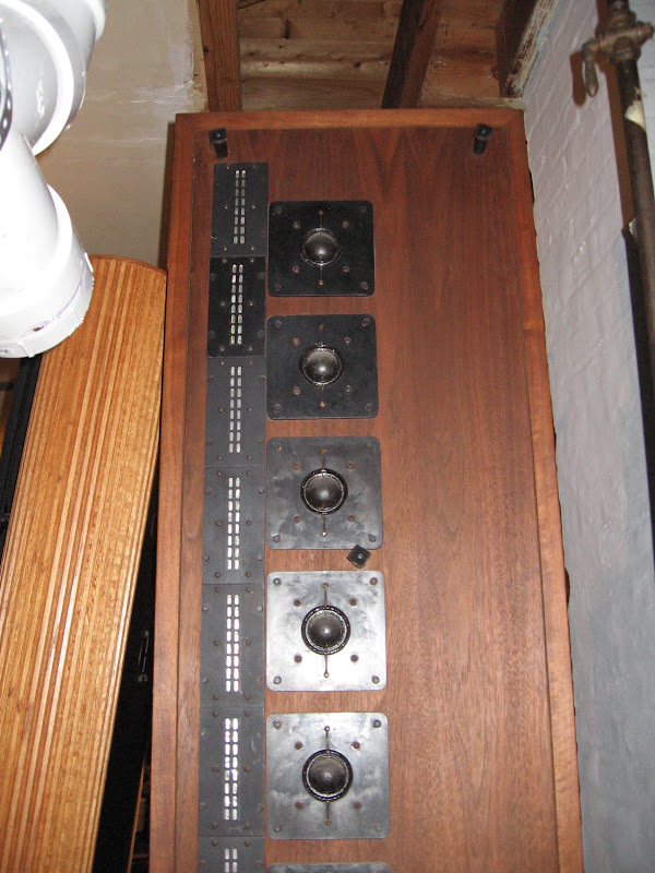

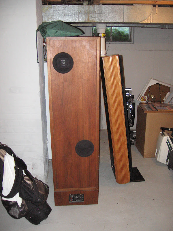

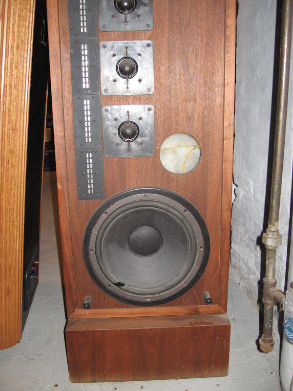

Pictures as promised. Not that great for now since they're in an awkward position (one is facing the wall about three feet away, and the other is facing the back of the first with about six inches to spare), but hey, it's getting crowded down there ;)
The fronts of the speakers are in very good shape, all things considered. Most of the scuffs are on the sides and would completely disappear if I restained. There's only one small veneer chip that I can see, thank golly. I was able to examine test the drivers in the Kappa's pictured by dragging them over to an old Sansui in another basement corner, but I still haven't been able to test the EMITs in the QLS1's since they're harder to move. Visually they're a little wrinkled, but are clean and at least seem intact. On first speaker, at least 11 of the 12 midrange tinsels need to be repaired. The seller was very surprised to find that and has no idea what happened. I cannot complain, however, since that is what enabled me to snatch them for pennies on the dollar.
Those look to be in very nice condtion :yes:
BTW I know a guy that refoams Watkins woofers cheap and has a pair of RS 2.5's and RS 4.5's you could listen to when you drop off the woofers :D
i just might have to take that guy up on it :scratch2: :) i took one of the woofers out and was happy to find that either the factory or the previous owner etched the wire colors above the terminals, so i don't have to worry about hooking them back up. i had hoped to bring the watkinses and kappa 9 woofers home with me from chicago, but no dice, so the refoam/speaker audition will have to wait.
