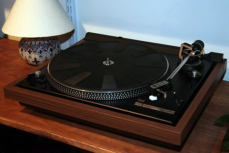

I recently got another TT - a Dual 504 with an empire cartridge. It took me a while to set this one up properly, but it sounds pretty nice now. What still irks me is the sound that seems to be coming straight from the cartridge, not going through the speakers. It sounds a little like a broken tweeter, and after noticing it on the Dual, I checked my other TTs, and they have it as well, only much quieter than on the Dual. I guess it also doesn't help that I tend to sit very close to the Dual when I am using it, and I usually don't have the volume turned up very high. Is this noise normal, and is there anything that can be done to reduce it?

I also noticed in your picture that there is no dustcover. A lowered dustcover would also help cut the noise.
That is a very clever idea! The reason you see no dustcover is that I don't have the hinges for the dustcover, although I do have the original cover. What I usually do is lift the cover off the TT for a night of listening and only put it back on once I am done and ready for bed. It's not too much work to put the cover on if that would cut down the noise, and I have a hard time seeing how it wouldn't. Kind of a cheap solution too, which I am always a great fan of, seeing that I am notoriously cheap :thmbsp:

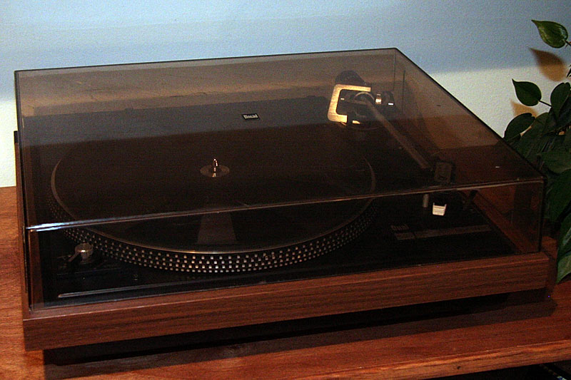

I tried the dust cover thing last night, and with the Dual having the cover down during playback is a definite improvement! Anybody who doesn't believe it, feel free to come by and check it out :D
Dual 504 with cover down.

As it happens, I have my main TT set up on a shelf where there is no space to flip open the dust cover. What I do is lift it off entirely and place it on a space I have reserved for this purpose on a higher shelf. When the Dual was in that space, I never bothered to install the Dust cover properly for that reason, and in fact I thought the hinges were missing. With the Dual now being set up as part of my basement system, and considering Dave's suggestion to combat the stylus talk, I had another look at the dust cover and it can simply be hooked into the back of the TT and then be flipped up and down. One can even adjust the springs that hold the cover up, thereby controlling the force that's necessary to open and close the cover. This little Dual is fancier than I thought!
Having the cover down during playback makes the stylus talk virtually inaudible, which is usually quite loud with this TT/cartridge/stylus combination. I can hear no feedback, so for me that's a non issue - at least for this setup.

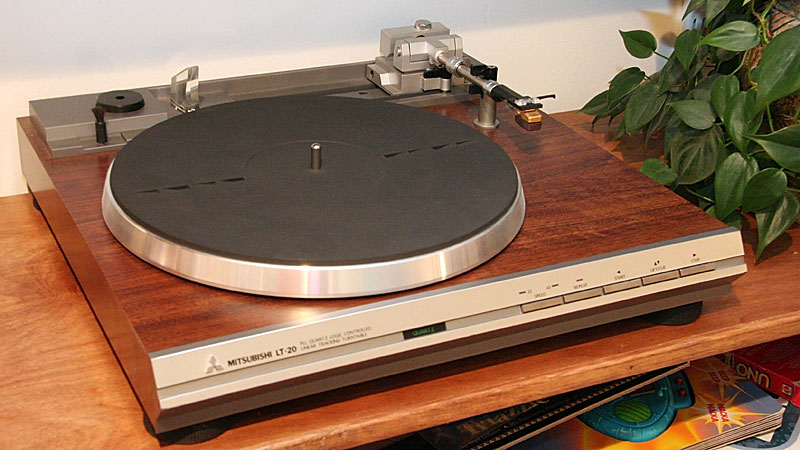

My main rig - Mitsubishi LT-20 direct drive, linear track TT with Audio Technica Signet cartridge. Unlike the Dual 504, with this setup stylus talk is a non-issue.

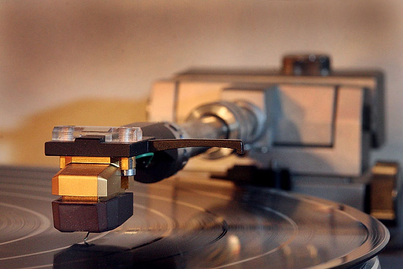

And just because I like photos, here is one of the AT Signet cartridge on the Mitsu tone arm. :)
