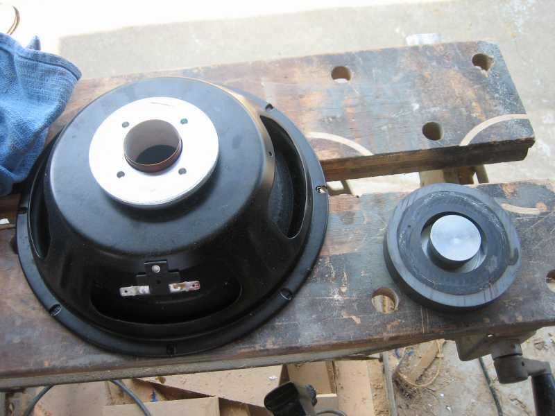

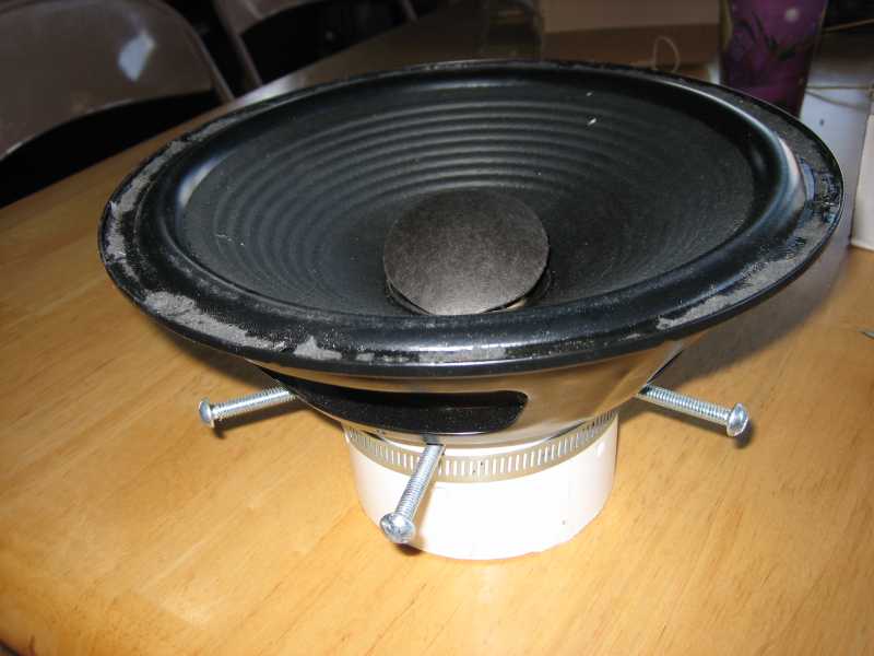

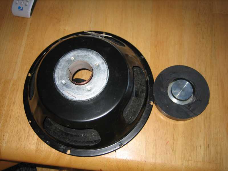

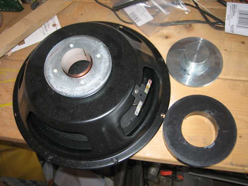

After several threads asking about shifted magnets, I figured it might be time for a “tutorial” on resetting them. Note, this is based on a thread and method by Scootchu here. I just added a few more words and pictures.
First step is getting things apart. Be careful not to damage the coil when you’re pulling the magnet off. I usually use 3 screwdrivers to get it started and then wooden dowels working around the magnet until I can get it lifted off the plates far enough to pull it loose. On the pair I was working with, I had one on which the magnet and core/backplate were still attached but the magnet had come loose from the top plate and one where all 3 parts had separated. In this case, glue the magnet to the core/backplate using your eyes to center. This particular backplate has a raised area for centering the magnet. If yours doesn’t then it’s not a big deal. You just have to be close on this, not exact.

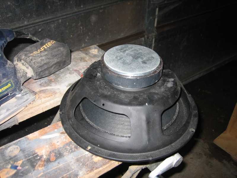

Once you have it taken apart, clean the surface of the magnet and the plate. Make sure to get all the old adhesive off and then clean the plates with a cloth and your cleaner of choice. Make sure it’s something that will be removed completely and not leave a residue.

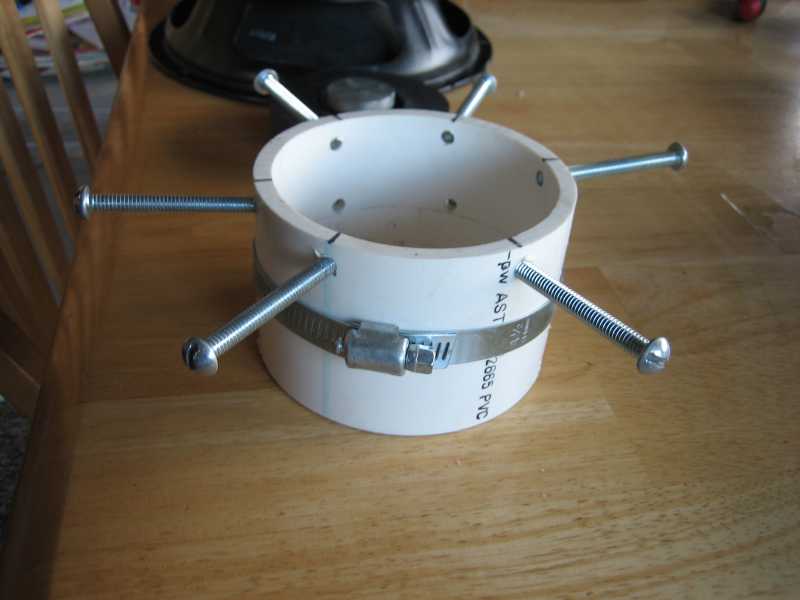

Now you need a jig. You’ll need a piece of PVC pipe that is big enough to fit over the magnet. For these (JBL) I used a 4” ID. Cut a slit along the length so that you can get it over the magnet and then cinch it down with the hose clamp. When I did a Pioneer (HPM-100) woofer I used 6” PVC and had to cut out a section so that it would cinch down and hold the magnet. Once you have the slit, you need to drill 6 holes (4 will work but is harder to center) more or less evenly around the jig. Make sure that they are high enough that the screws inserted in them will contact the top plate and not the magnet. You’ll have to figure out hole size based on the screws you use. I used ¼” x 20tpi screws. Scootchu used thumb screws, I used machine screws, either will work.
I like to do a dry run to make sure that there’s nothing sinister going on. There are a couple of ways to get the magnet back on. Scootchu clinched the magnet in the jig, got it centered up close enough, and then release the jig so the magnet would jump into place. He used a rubber band and a couple of pencils to hold the cone/coil our of the way. Then did the fine work getting things centered. These particular woofers had a surround that was pretty tight and I couldn’t get the coil up out of the gap completely so I just dropped it in by hand while holding the coil up as high as I could and using my fingers to keep the magnet from snapping in from too far away. Be careful doing this as these are generally strong magnets and can pinch the heck out of you. With a finger completely between the magnet and plate it’s not too bad. Once I got the magnet on I slipped the jig over, tightened down the clamp, and started adjusting the screws.

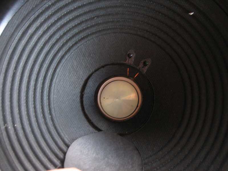

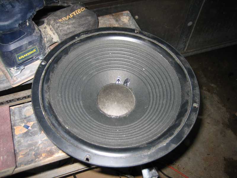

You’ll have to have access to the gap so you will have to cut the dustcap out at least partially. These woofers had the cap cut out about 95% of the way around so they can be re-glued afterwards.

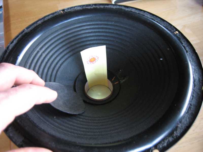

You can look at the gap and get things close. Once the coil will move freely, I use a piece of paper (fairly thick letter stock in this case) as a feeler gauge. I work around the core looking for tight spots and adjust the screws accordingly. Once things are centered up as best I can get, I hook it up and listen to something paying attention for rubs or any other extraneous noises. If that looks good then I pull it apart again and do the same thing with glue involved. I used a 30 minute, 2 part epoxy. It’s pretty strong stuff. You have 30 minutes to get things centered up and 12 hours to wait for full cure.

I'm glad there are folks like you to clean up after my messes, Kelly. :thmbsp: Yes, be careful to use just enough glue to get it done and I like to keep it towards the outside of the joint so if I do get some squeeze-out it'll go to the outside and not bind the coil up. Sorry, but I don't have pictures of that step. I'll try to remember the next time I do one.

This process works great but for some reason I saw 4" and bought a four inch PVC coupler (if you don't want to buy a section of pipe). I only needed 3" for my Polk Speakers and had to go back and grab a 3" coupler, schedule 40. To get a really tight fit on the magnet I cut a 1/2" section out of the length of the coupler (with a chop saw) and used a band clamp to tighten around the magnet.
On my first version I used a drill to make undersized holes and then reamed them out with the same bit to get them close to my 1/4" bolts. The bolts will self-thread in the plastic, no need to use a tap and die set. The holes didn't line up very well when I did it by hand so I resorted to the drill press and then reamed out the holes with a hand drill, this worked much better.
I used hex-head bolts and a socket wrench for better control and set the magnet on top of the bolts before tighting the band clamp and lowering on the speaker.
