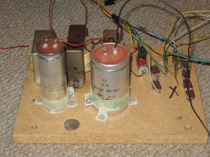

yeah, it's pretty crazy. those caps are highpass filters for the DVC Watkins woofer. the larger value is probably for a rolloff at something like 20Hz. these woofers will play lower than that (but not in a very controlled way) in this cabinet. i'll avoid the Monster and stick to PE. i also think i'll take your advice and avoid replacing the inductors for now and see what improvement just the caps and resistors give. that will reduce my costs a lot. i'm going to be biamping, so i don't think that i'm going to be running into any problems (more likely the contrary) by lowering the DCR, but we'll let sleeping dogs lie.

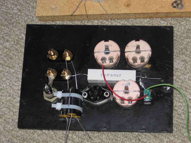

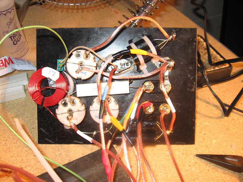

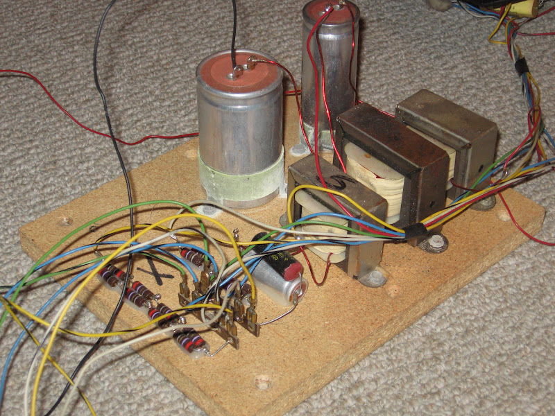

just for reference, here's what I'm starting with. i'm going to do the work on a spare set of XOs i pulled from 2 parts speakers, then i'll swap XOs when i'm done. the bigger woofer cap is larger than a lot of amplifiers' PS caps - there's a nickel in there for scale.

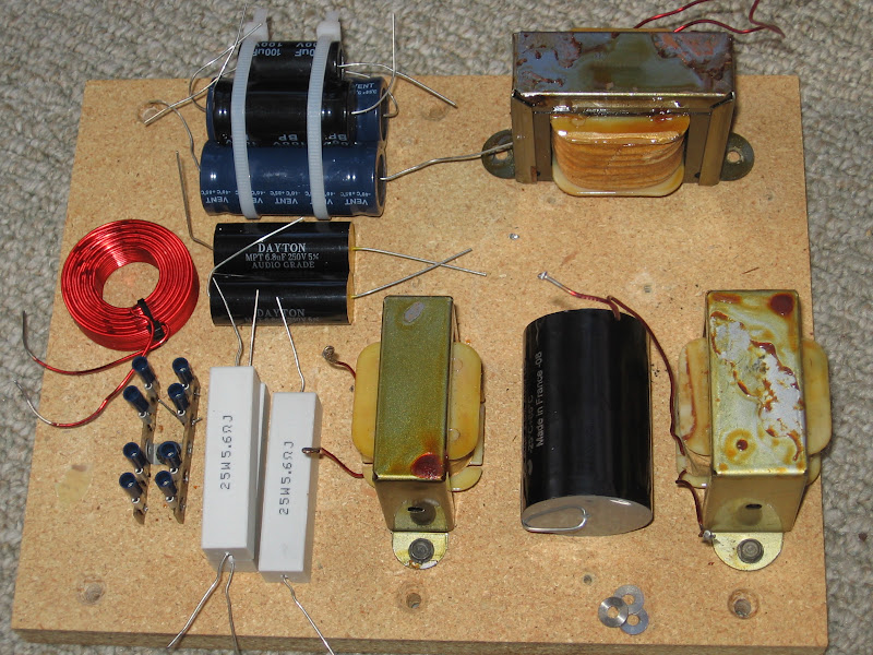

Got the parts this morning. Here's a mockup. A lot cleaner than before, although the wires are in yet. Look at the size of that Solen 40uF!

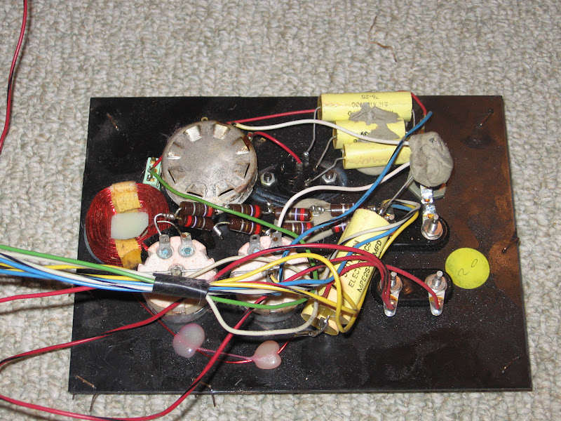

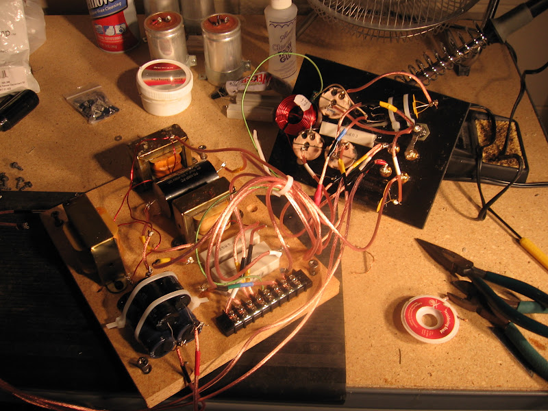

good to hear. i'm not the best solderer, but i got most of the XO above done last night. two mistakes, though - tapping the center of a pot when i needed to tap a side, which i'll have to undo, and putting a cap and inductor on the back side of a circuit instead of on the front, which should make no difference. i'll this side done tonight but i don't have an amp now to test it with. the end of spring break will fix that, at least.

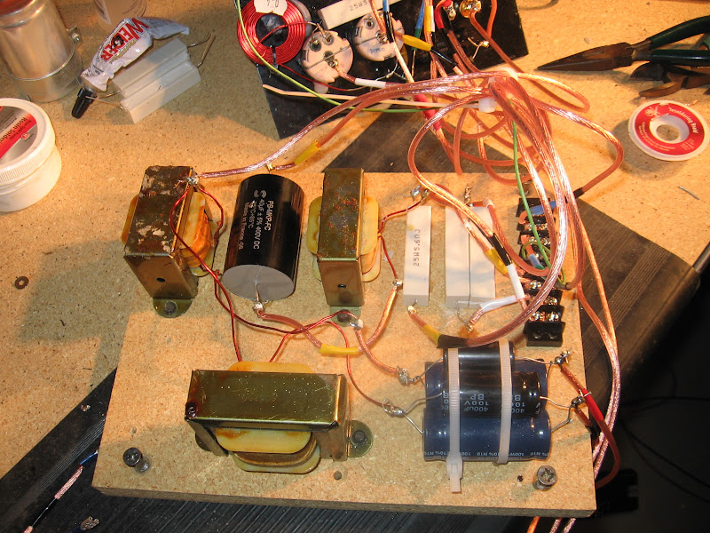

Got both of the XOs done now. The difference appeared to be not so subtle when I installed the first completed one and A/B'ed with the original still installed in the other speaker. The sound was less veiled, the treble seemed to have more definition, and the sound quality at low volume seemed to be improved. I believe vocals and upper midrange are less muddy, as well, though they were still very good before.
Here are some pics of the final product. I'm pretty happy with how it turned out.
it's interesting how capacitor sizes have changed over time. notice how much smaller the new woofer electrolytics are (navy and black). in contrast, the new 40uF poly midbass cap is enormous compared to the original Callins one, which was just a bit bigger than the new white sand-cast resistors.

I just picked up a pair of QLS-1's last Saturday and will be looking at recapping my crossovers soon. You may be interested to see yet another version of these crossovers here, I'll post some driver differences in your other thread. I don't know if the history of these can be followed by serial numbers, but mine are 7000616 and 7000085. Obviously an unmatched pair but at least I got a left and right!
If the lower serial number denotes a earlier version there was a time before the large can capacitors were available. I haven't totaled the values of the 9 caps in the 7000085, but the right has the 1600mf and 1400 mf I think you mentioned from your donor QLS1 parts.

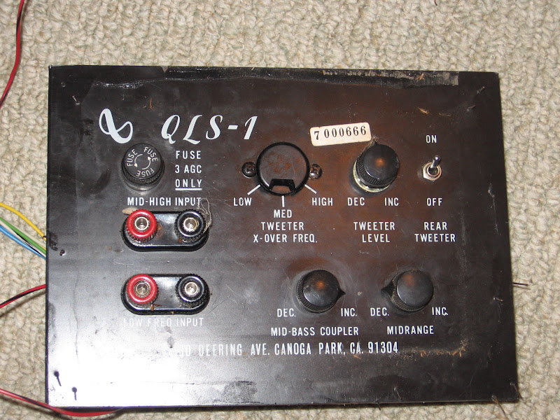

first of all, sorry it took so long to write back. well, the wiring is pretty difficult to interpret for the first time, but with some help it will all make sense.
the tweeters and mids are both wired so that each nearest pair is in series, with all pairs in parallel to each other. don't worry so much about the resulting DCRs, but you should know that the proper EMIT range is 4-6 Ohms, the mids between 7 and 8 Ohms, the midbass around 7 Ohms, and the two woofer coils at about 2 Ohms and about 5 Ohms. nominally, you have to consider the impedance that includes how the inductors and capacitors behave at different frequencies, so with those you get something near 4 Ohms. in an old test report, they found that these never dropped below 2.5 Ohms, so the challenge isn't so much to have an amp stable down to extremely low impedances, but because of the low efficiency you need to have massive power and lots of reserves to do the Watkinses justice without clipping and killing the EMITs. about 500Wpc @ 8 Ohms should do ;) of course, most amps that meet these other requirements are also stable down to 2 or even 1 Ohms, so we're sort of mincing words.
your best aid in wiring is to pay close attention to the colors. i found my later XO to wired exactly like the schematic once i was able to trace the circuits out, so the online schematic is really all you need. the simplest thing to do is start at one speaker binding post and follow one wire through everything it does, writing it all down.
one hint. if you look at the schematic you'll see the pots represented as resistors with lines leaving the top. that line leaving the top is the center tap, which is usually at the center of the back of the pot. most of the time, this is what eventually goes to the speaker. if all three taps have something wired to them, that means that one of the sides is connected to a resistor that then goes straight to ground, which you'll see in the schematic. i was careful to make separate pot diagrams of what was actually in the speaker before i disconnected everything.
another hint. when redoing stuff, stick to the order represented on the schematic. makes your own work easier to follow and check on, and it will ensure that everything sounds right.
as you have more questions, let me know. once you pull out the XOs (which is pretty easy since the wires going to the drivers disconnect quickly, the wood plate unscrews, and the back plate can be freed from its adhesive with some force and patience), expect a few weeks of downtime unless you're a quick solderer and a quick study.
