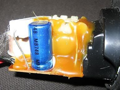

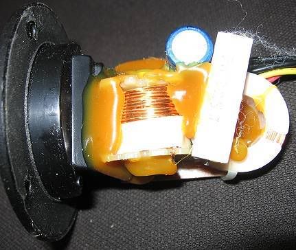

No tweeter in one, and its woofer's open, so I installed a JBL 116H, instead, Blue, which balances better with the stock tweeter.
With nearfield LF response of the JBL normalized -1.8 dB at 500 Hz, it still plays lower frequencies with more SPL, and reaches 2 Hz lower than the stock woofer, 42.6 Hz (-6 dB):
attachment.php
Minimalist polyfill damping, and a crossover even Minimus 7s put to shame, these are prime upgrade candidates:
attachment.php
Edit: Installed R-13 fiberglass damping all around, which restored the stock bass "voice," and lowered the -6 dB frequency another 2.2 Hz to 39.4 Hz, for a total improved bass extension of 5.2 Hz w/JBL 116H woofer.

Hmm.... A-60 Series 2 SEAS Dome tweeter version has a different Xover.
4.7 uF Cap
