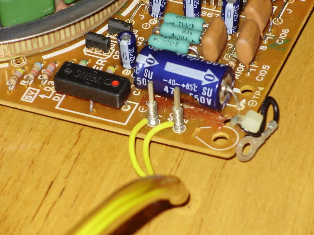

Two more quick power supply questions...
The two yellow wires from the transformer to the main board are (I presume) low voltage. Are they still AC? I'm guessing that they are since they aren't color coded. On this picture you can see that they are connected to the main with several wraps around long binding posts rather than just soldered as most of the connections are. What is the purpose of this? I suspect that knowing why this was done could be important to my decision making.

If it was me, and I really wished to remove the transformer fom the plinth, I'd lengthen the wires and leave the boards and the switch inside the plinth.
The wrapped posts are just a way of securing the wire in a robust manner, the designer didn't want the AC leads from the transformer breaking off and causing havoc.
I would also forgo any redesigning of the grounding design, only adding a ground to the chassis from the transformer, there is potential for a ground loop that doesn't have to be implemented.

Anytime you can move an inductive field away from sensitive signal apparatus or shield it, is probably a good thing. I don't know from any personal experience if it is better or not for turntables, never done it.
If it were I (If it was ME is grammatically incorrect, - if it were I who were doing this, not ME is doing this) since the turntable works, any modifications could very well break this fact - I'd worry about the arm at this point, to see if any reasonable solution is available. PLUS, the arm is an important part of the grounding circuit, so any changes to the ground BEFORE mounting an arm may have to be totally redone once the arm is on. Leave the turntable motor and supply as is until the whole thing is functioning.
Actually, in looking again more closely at the transformer and associated PCB, I now notice that the transformer is mounted by heavy rubber grommets. This would prevent the transformer from being grounded to the chassis. I also notice that the associated PCB has no etching (no contact) at it's mounting points. So unless anyone can persuade me otherwise, my plan now is to put them offboard with five wires and keep the switch in the table.
I know that some Grado carts can become noisy as the move to the center of a 1200. The accepted idea is that the noise is coming from the transformer. They call it the "Grado hum". My AT doesn't have a hum issue, but I reason that if the transformer can cause a hum with any cartridge, then I am better off moving it.
