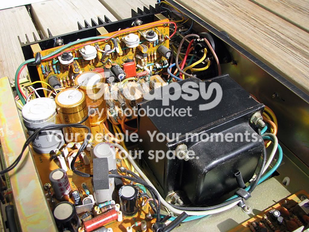

Nude pic! Looks like any old Marantz, doesn't it? :thmbsp:
That transformer is very large! See those two gold caps on the psu board? Looks like a previous owner has done some repairs on this one. The filter caps are supposed to be 2x 4700uF, but they have coupled up two 2200uF ones as a replacement. And the original one beside it has certainly seen better days! This receiver is in a serious need of a recap!
Another angle. You can almost see the output transistors on this one.
And what do you know? There they are! :)
