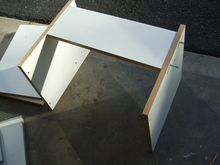

The exorbitant price of record cleaning machines compelled me to fabricate my own. The thought of a $500-1000+ LP cleaning machine is just plain silly. I cannot comprehend the idea of spending the equivalent of a house payment for an accessory. Surely there are better uses for that much money.
In an effort to subvert the profiteers, I stumbled across the cleaning arm of that very same $1000 cleaning machine and purchased it for $65. Then set about to fabricate the functional parts of that very machine.
Here's what I conjured up in a single afternoon.

The cabinet was simply melamine covered MDF which is available at any home improvement center. I wanted to be able to wipe any cleaning solution that might spill during operation. But simple MDF or wood is perfectly acceptable--more inline with the Nitty Gritty look. I simply cut pieces to size on a table saw and then assembled using simple wood screws. I was very informal on the dimensions paying little attention other than the top piece which had to accommodate a full size LP platter and the vacuum wand.
