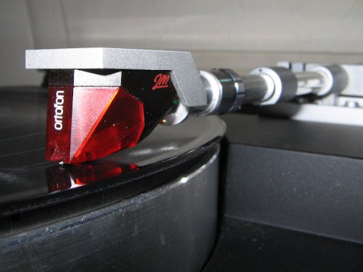

G'day all
Not sure if this has been done already but I couldn't find one so if it's a repeat the mod can kindly delete it perhaps.
As we all know, cartridge and tonearm take up big part of this vinyl hobby and we, or at least I, love their looks!
So why don't we show each other what we've got?! Here are my humble & modest parts! :banana:
Ortofon

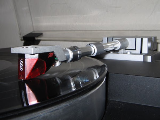

Hitachi PS48 tonearm
