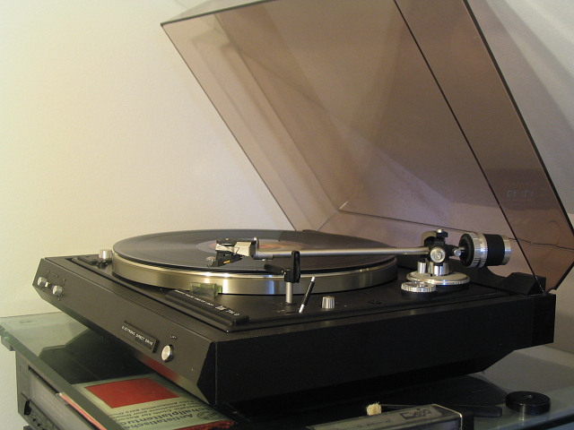

I decided to write this up after buying a Dual 714Q turntable, and
learning about all its quirks regarding the proprietary Dual ULM (Ultra
Low Mass) cartridge, standard 1/2" cartridges, long and short head
shells, TK adapter plates, and difficult to find specs regarding the
original deck, its original ULM60E cartridge and DN160E stylus, and ULM
tracking stylus compliance(see further down) issues.

When I finally picked up the 714Q, the second hand store actually found
most of the original Accessory Kit, which includes a longer headshell
for mounting standard half inch cartridges, the required TK-24 mounting
plate, and screw-on counter-balance weights for the back of the arm for
when using the heavier long headshell and 1/2" cartridges. So I really
lucked out there. The TK-24 that the kit came with is silver. It is
usually black when bought separately.

Some notes on the Long and Short head shells and TK cartridge carriers:
I believe that the stock setup for the 714Q / 731Q was with short head
shell, TK-26 cartridge carrier (Dual service part number 236 242), and
Dual Ortofon ULM60E/DN160E. Here are some pictures of mine.

Well, the new table arrived, it's really in nice shape for what I paid (75.00 + shipping), even the dustcover. I'm still a bit unclear how to get the arm balanced, as I'm used to the typical swing arm free, move counterweight to balance arm, set to zero, then adjust your force. This table is different. Any quick tips are appreciated.
picture.php
(...) I'm still a bit unclear how to get the arm balanced, as I'm used to the typical swing arm free, move counterweight to balance arm, set to zero, then adjust your force. This table is different. Any quick tips are appreciated.
Well, it's a dynamically balanced arm - so the counterweight is only used for creating the balance, while you use the small knob on the right side to dial in the tracking force. I.e. tracking force is generated by spring tension on this type of arm. Hence the procedure is just pretty much the same, but not quite: First set VTF and anti-skating dial to zero, then balance the arm and finally dial in VTF and anti-skating.
Greetings from Munich!
Manfred / lini
