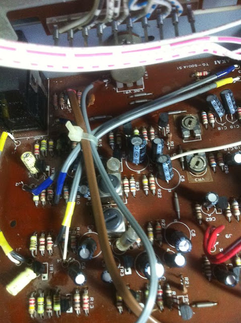

I replaced transistors 1,2,3, 8,9,10 and 1b, 2b, 3b, 8b, 9b and 10b.

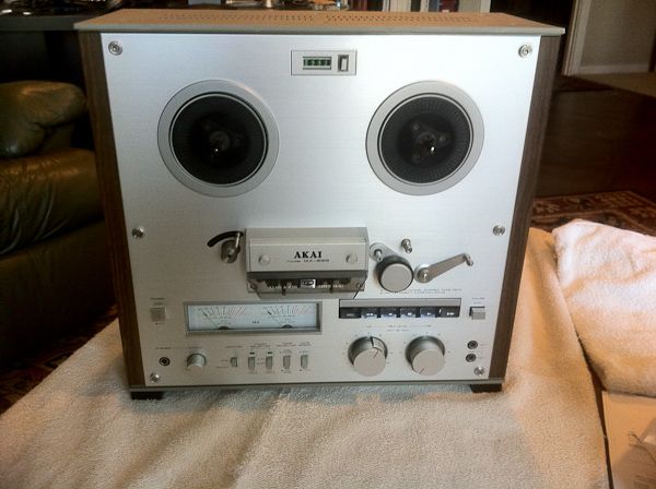

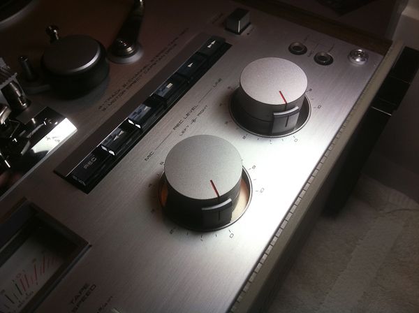

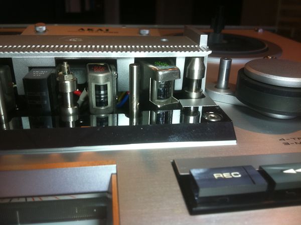

I hooked it up to my system and it sounds great. I tested recording and does a nice job. Here are some photos:
Interior with new transistors:
Detail:
Heads and pinch roller:
