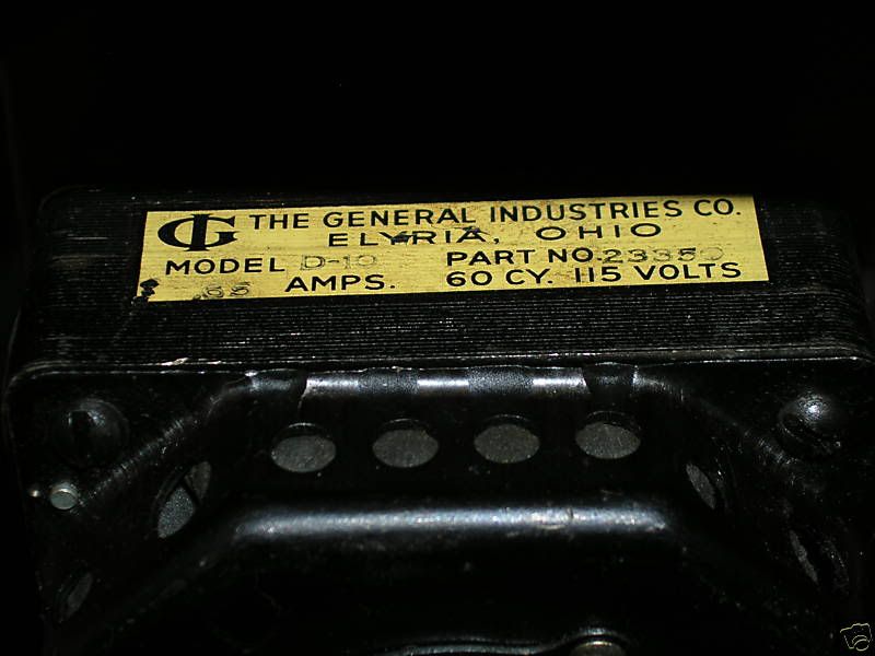

What drove these wheels?
The black cube from hell, thats what! I picked up on a nickname from it, coined by another member here, mopic5, as he is involved in a similar deck project, with the same motor. He called it, most appropriately, the Borg Death Cube. The name resonates in infamy.
08.jpg~original
09.jpg~original
The Borg Death Cube had a three step capstan-pulley that was seized to it, and it took forever to get it freed.
Well, in dissecting the OE drive-line, I found that the motor mounts were shot, and had been improperly hung, with washers that caused a rigidity of the motor to the top plate, rather than as a suspension as had been designed.

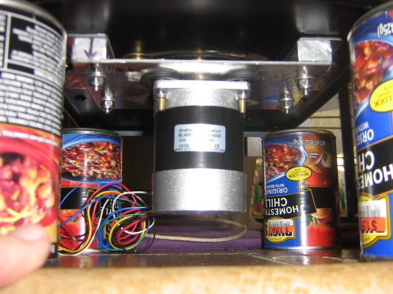

After months of trying to fix the motor, I gave up on it, and, decided to install a new motor into the old original three-wheel driveline.
So, I started shopping out motors and had a hankering to build it with a DC motor, and a precision controller.
I found a motor, based purely on its size comparison, to ensure that I could fit it into the same space as the original assembly. It was from a local company that designs and builds the controllers here locally, and imports the motors that they re-badge.
IMG_6137JPG.jpg~original
IMG_6139JPG.jpg~original
And it had a matching driver that offered intimate monitoring and control:
IMG_6150JPG.jpg~original
The driver has three hall sensors around a 360º circumference. They monitor the speed of the motor, and keep it locked at an unwavering dead-to-speed locked RPM. It does not slightly wander off speed. I can carry speeds from a zero-stop to hundreds of RPM at the platter.
A new motor mounting plate is built, and new motor mount suspension grommets are installed at each point.

OK,... So, new high tech motor and mount finished; Check, test.
Result: Newly realized driveline noise; AND, worse -- A realization that the original geometry of the three wheel design favored the newly developed 33 and 45rpm speeds, and only included the 78rpm speed as a nice added speed, as it was still so close to that era. The deck was fundamentally flawed and noisy if you tried to adjust the motor tensioning to accommodate all three speeds in a single adjustment.
