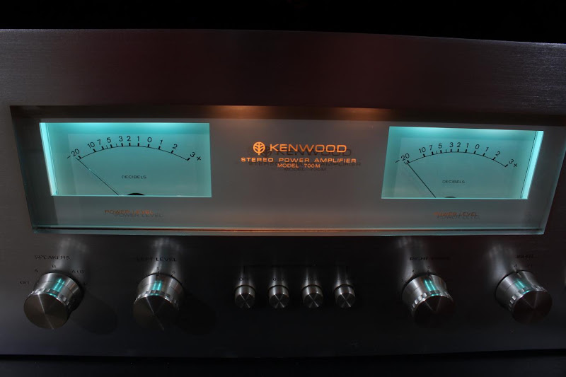

Can the Decibel meters on the Kenwood 700M somehow be used to calculate watts?
Yes. If the meter is scaled to be "-0dB" as max unclipped output.
Wherever the needle peaks, say -3dB, you can calculate the power. If the power amp output capability is 100W into 8 ohms, the max output voltage is sqrt(Watts*ohms) = sqrt(800) =28.28Vrms. that is your "-0dB" meter indication. "-3dB" would be 10^(-3/20) = 0.707 That's the ratio.
The ratio * 28.28(V) = 20(V)
To find the power: (V^2)/load = (20^2)/8=50(W)
