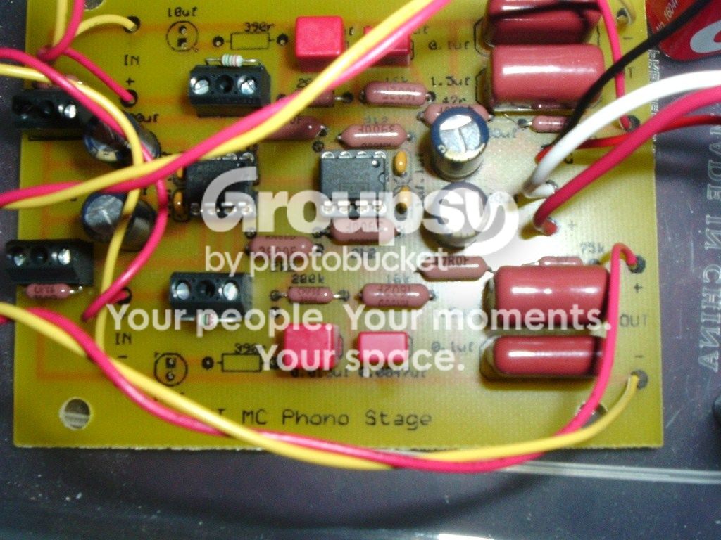

Never being satisfied for long I have been working on a new moving coil phono stage the Hypnotoad Moving Coil Phono Stage. Here is the first working prototype, well the only one actually. It worked first time I fired it up to my surprise and I only finalized the design last night. As you can see I had a few different options on the PCB and some of the component values were changed after I etched the PCB.
It's super simple to build, is dead quiet and has plenty of gain which can be adjusted easily to suit different carts. I used the trans-impedance concept for the input stage as I believe that it's the best way to go. Makes me wonder since the idea has been around so long that it hasn't been used a lot more.
I nearly went with a non-inverting output stage but changed my mind as I realized it would be out of phase. I have a personal preference for active equalization as well so that's the way I went.
RIAA is accurate, less than 0.4db deviation.
2 x OPA2134 dual circuit op amps.
Very few caps in the signal path and bypassed output caps.
Only 10ma's current draw.
Runs very nicely on 9v batteries at the moment but will try it later with my lantern batteries setup which seems to always sound a bit more authoritative on my other stages.
Right out of the blocks it sounded special, the bass was a tad heavy and the highs a little laid back at the first needle drop, but after only a couple of hours it's opening up nicely. So nicely I am thinking I don't need to change a thing, yeah right who am I kidding.
I did a comparison between it and the Phonoclone 3 and even though the PC3 is a fierce contender and the best phono stage I have heard. That was up until now, the HTMCPS has a slightly more forward sound stage compared to the PC3 with a slightly smoother more open sound to it. It's like another veil has been lifted from the sound.

I will be doing more listening over the weekend and working on the Gerber files so I can get some PCB's made.
I need to listen to it through my SSP as well, the OPA2134's are surprising in this design, I was never really keen on them. I will try some other op amps as well but doubt they could be better.
More listening and the more I listen the more I am impressed, I tried a LME49720 op amp in the RIAA stage and found the soundstage collapsed a bit so put the OPA2134 back in.
I played my favorite test track Because on Beatles The Love album and the birds chirping and flapping as well as the fly/buzzing are clearer than I have heard so it has detail, smoothness and soundstage in spades.:banana:
I haven't tried the AD823 as I am liking the OPA2134's so much.

Hypnotoad, thank you so much for offering this to the community. I really can't wait to hear it on my MC carts.
I was wondering about the R1 and R2 values. Should I just use the Phonoclone3 calculator or is there another way to calculate the R1 and R2 values.
For example, here is what I am picking for the following cartridges using the PC3 calculator:

Using the PC3 calculator you will end up with too much gain. Simply multiply the value of R1 x 10 to get R2 for lomc carts that should be close enough.

Overall around 60 - 65db, the second stage has 35db, the first stage will vary so it the whole thing can easily go up to 75db.

Do we need to calculate only R1,R2 or R9 and R10 also needs to be changed?

R1/R9 are the same as the cart resistance and R2/R10 are the gain resistors. Free PCB won't let you have the same component number more than once so you have R1 for right channel and R9 for left channel etc.
So if you have a ordered a pair or resistors for R1 and a pair for R2 you are set, hope this makes sense.
