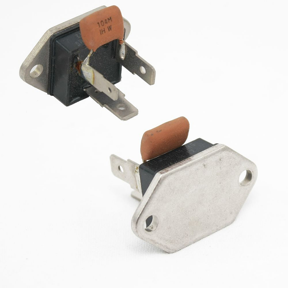

I finally got around to trying a Triac to turn on and off an amp and it was a success. I am still looking for the down side of this mod.
This mod should work on any amp and the power switch load will be reduced to around 120 ma and no arcing. The power switch will now last longer that you will.
The test bed is a Lafayette LR9090 (Setton RS) series known for lunching on power switches. This switch had the NO contact for power "on" inside the switch gone, just smoky residue left. This special case required a relay NC contact for the PA Mute / protective relay dump on power "off". I moved the switch NC contact to NO position for the power on function.
Triac used was a Littlefuse Q4025L6 (Mouser 576-Q4025L6) Rated 400VAC 25A RMS for highly inductive loads and tab isolated. Way over rated. Yea olde Fluke gives around 7A AC peak on the 100 ms scale at power "on" and idle current of 0.6A AC at low volume. The Triac data sheet is on Mouser: http://www.mouser.com/Search/Refine.aspx?Keyword=q4025
Note: Triac suffix L6 is a TO220 case isolated tab, if you prefer solder loops for a buck or so more the J6 suffix is a TO218X with loop leads and isolated tab.
For me, the isolated tab and not having to bother with mica and screw isolator is worth a buck or 2. You?

OK!, so I lied about being expensive & difficult
I found a place on the chassis for the Triac that the leads would fit, drilled a mounting hole, soldered directly to the TO220 leads and used heat shrink over joint and lead.
Initial testing was done by removing the transformer primary fuse and hooking up a 100W bulb for a load. After a bunch of switching the bulb on and off, I put the transformer fuse back in and tested and tested...... The amp has been switched on & off left on for days and no problems.
On state voltage drop is 0.8 to 0.9 VAC which agrees with the data sheet curve
