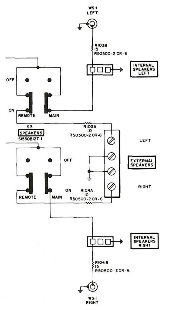

I am about a month into vintage audio. Recently acquired a Custom Electra E-492 console and a pair of Fisher xp-9b speakers. All in good working order. I have the xp-9b's connected on the WS1 terminals to listen to the console speakers and the xp-9b's at the same time. But the level of sound from the xp-9b's is almost imperceptible. Any ideas on what the issue is or another possible configuration with the console's terminals to enjoy both sets of speakers at the same time? Thank you.
Hello and welcome to AudioKarma. Does your 21-R have standard screw terminals labeled for external speakers? If so, I would try those instead of the WS1 RCA jacks. If you are still not getting much volume from your XP-9B speakers - assuming you have tried them with a known working receiver or amp to verify they function correctly - then I would check the resistors R103A/B and R104A/B. (See diagram below from the 31-R which should be configured similar to the 21-R.)
Note that these resistors are in series with both the WS1 jacks AND the external speaker screw terminals - presumably to reduce the volume of any outboard speakers so that the main speakers are dominant. You might consider bypassing those resistors if you want to hear your outboard speakers at full volume.

The WS-1 speakers are a Mid/High speaker. It's not designed for FULL RANGE. It enhances the mids and highs, due to the current height of the console mids and highs (in other words it brings the mids and highs out into the open) and enhance separation. I use them on my CEVII, or FUTURA VI as they are real bassy with just the stock speakers. The resistor limits the amount of current / voltage to the speaker so you don't do a Marty McFly with it. It also presents a load to the output section. These are the STANDEE Brand resistors next to the output crew points. Note that the "B" have a 10 oHm resistor and the WS-1's have a 15oHm resistor. The WS-1's are in parallel with the Mains. The WS-1's IIRC are 8ohm as are the console's speakers.

Presume all speakers are 8 ohm. A & B are parallel. The Standee are in series.

Try the XP-9's by themselves using the INTERNAL spkr terms. Carefully insert the bare wires into the Molex for the Internal's. If the XP-9's are still not coming up to speed, then it's a spkr problem. (basically you bypassed the resistor on the WS1 part of the circuit. )
TheRed1: Thanks for the bypass idea. I did this and it worked fine. Do I have to be concerned with connecting the Main Console Speakers and the Xp-9b's on the same terminals? If I hook up to the remote speaker terminals, I am forced to choose between one set or the other with the Remote Speaker switch. Maybe better to decide if I need the additional speakers or not.
