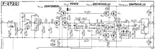

Part 2: Tone Control Circuit Board (F-2720)

Signal Path Capacitors:
With the tone controls "defeated", the signal first passes through the input high-pass filter capacitors (C05, C06) which were 0.33µF polyester film types; these were upgraded to 0.33µF Panasonic polypropylene film types. The stock capacitors in the low-pass filter (C07, C08) were ordinary ceramic capacitors at 22pF (listed as 10pF in the schematic); these were replaced with same value C0G capacitors. Similarly, C23 and C24 were ordinary ceramic capacitors at 22pF (listed as 10pF in the schematic) and these were also replaced with C0G cpacitors of the same value. The output high-pass filter consists of a pair of polarized 100µF/6.3V capacitors in series (forms a "bi-polar" capacitor) for each channel (C27/C29 and C28/C30). Each capacitor pair was replaced with a single 47µF/16V Nichicon ES bi-polar "audio grade" capacitor (jumpers were installed in the vacant capacitor positions). Also, the film by-pass capacitors for the output capacitors, C25 and C26 which were 0.47µF polyester film types, were upgraded to 0.47µF Panasonic polypropylene film types.
With the tone controls "on", the signal additionally passes through the high-pass filter capacitors (C21, C22). These capacitors were originally polarized types rated at 10µF/25V; the replacements were 10µF/35V Nichicon ES bi-polar "audio grade" capacitors. Similarly, the capacitors C45, C46 capacitors in the output high-pass filter of the tone control circuit were originally low-leakage polarized types rated at 10µF/25V; the replacements were 10µF/35V Nichicon ES bi-polar "audio grade" types.
With the subsonic filter engaged, the signal additionally passes through a pair of polarized 4.7µF/50V capacitors in series (forms a "bi-polar" capacitor) for each channel (C33/C35 and C34/C36). Each original capacitor pair was replaced with a single 2.2µF/50V stacked film capacitor. Also, the film by-pass capacitors for subsonic filter, C31 and C32, were removed.
Non-signal Path Capacitors and other Components
The local decoupling capacitors C39, C40, C41 and C42 were originally rated at 47µF/50V; the replacements were low ESR types rated at 220µF/50V. The VD1212 dual diodes (D01, D02) were each replaced with a pair of 1N4148 diodes in series. And the notorious failure-prone 82ohm fusitors (R37-R40) were replaced 82.5ohm/0.25W metal film resistors.
