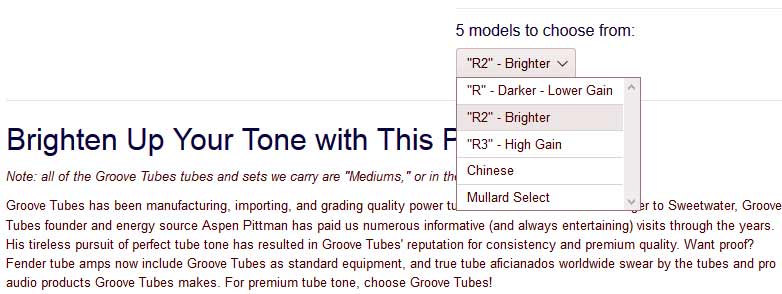

For preamp tubes in my guitar amps I love the Groove Tubes version of the Sovtek 12AX7LPS (GT-12AX7-R2) and the Groove Tubes version of the JJ ECC83S (GT-ECC83-S).
"brighter tone, lively and responsive"
Sounds like just the ticket for a center channel ... bookmarked!
Also looks like they have a few varieties available depending on your preference.
I'm assUming the R2 would be the way to go for this application. Although the R3 "high gain" might give me a bit more punch. Maybe a nice touch with a set of heavy duty 7189 equivalents ... maybe not so much with less durable power tubes.

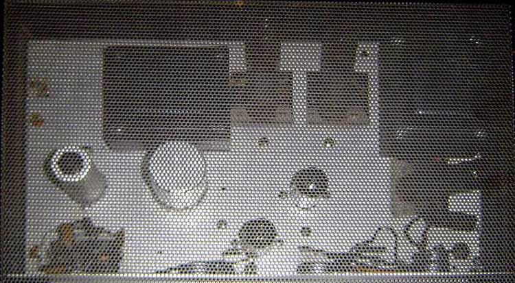

Ski could you pleas post a pics of the insides with an underskirt also!
I have HF-12's and think they are basically the same if I remember from reading? The one in your picture says HF-12A.

** ShadowDog ... the HF12A is identical electronically to the HF12. Only differences is cosmetics. I've got it buttoned up in the rack right now, but I'll get a pic next time I get to gettin' on wit it ...
Thanks! No rush! I figured the guts were the same! Anyway they sure are nice and compact and easy to listen to.

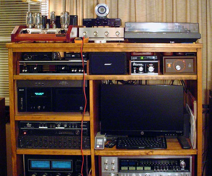

As is, kind of a tight fit in my "minimalist" system ... there's maybe an inch either side, and the entire case except for the faceplate is mesh with an open back for ventilation for anyone wondering about the DAC parked on top. That's also tube, so I wanted to keep it high. Fairly tall legs on that as well, so no concerns here. Just listened to Brothers In Arms and the case was barely warm.
One casualty was the Vibrapods that were supporting the ST120 tuber. Those are quite large and there just wasn't enough room any more. Have to look into another option there as there is quite a bit of vibration transmitted from the rack. No microphonics, but I'd prefer to calm things down a bit if I can.
PS ... the Eico is feeding the Bose VS100 located directly underneath.
