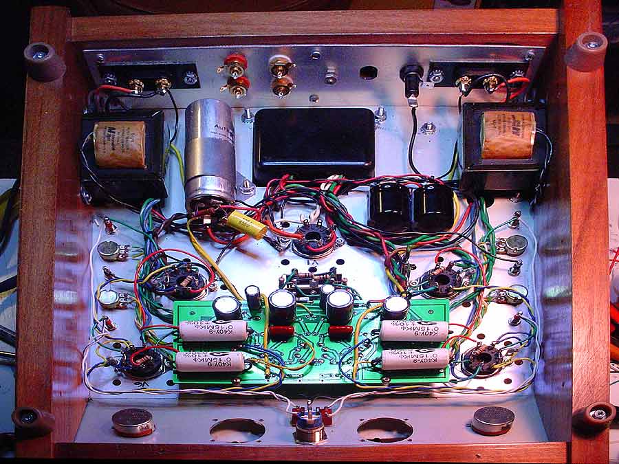

I went thru all that a bit back and had some help from a couple of the wizz ... er ... whiz kids here on AK. My speakers are large - McIntosh XR16's - and run 91db efficiency, plus, I like LOUD. Took some SPL readings and I'd be cranking around 95db average with peaks in around 105db.
Eh? What you say?
I said ... I'd be cranking around 95db average with peaks in around 105db. :D
Anyway, we all decided that the standard 20-35wpc wasn't gonna do it and keep me happy, so I decided on a Latino ST-120 kit. That's conservatively rated at 60wpc, and more like 70wpc real world.
Get's rave reviews, and I think it's a right nice piece of kit. Haven't quite got it built yet ... but getting close ... real close ...
