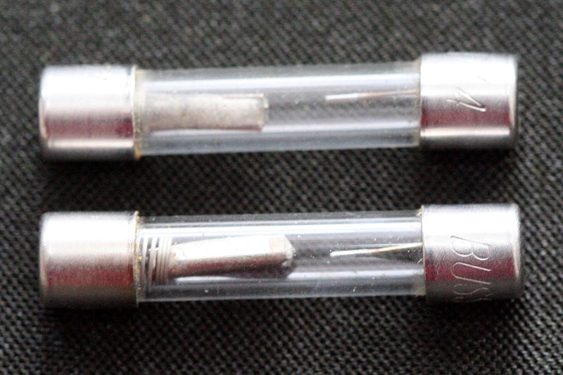

And - low and behold - below the power supply in the picture, just left to the big blue thingys are two of those old fashioned fuses like there used to be in 1970s cars:
They sure look dead to me. That would be so awesome if that was all that's wrong with the thing - well kinda stupid too, because I had that thing sitting in the basement for years not being able to use it, but I would get it back :music:
Now where does a man get replacement fuses for these dinosaurs? It says on them:
BUSS MDX4
125 VOLT
Both seem identical.
Many thanks
Frank
They are 4 Amp slow blow fuses. You can try RadioShack. Chances are if both fuses blew something is really wrong, like blown output transistors. If that's the case, they will blow immediately when you turn it back on. I am on the East Side if you want to get it serviced.

I've seen that particular type of fuse fail like that frequently and nothing be wrong with the unit. If you look close the fuse wire has pulled out of the solder. What happens is the spring is constantly pulling on the solder connection which is weak and eventually just pulls apart. It's definately worth trying new fuses.

A 3020 has FOUR fuses. The voltage regulator/power supply for the preamp, and the input stage for the power amp is attached to the back wall of the chassis. If those fuses are blown, it could take a long time to trace down the exact cause. If those fuses are fine, and the preamp is still functional, then you have eliminated 3/4 of the circuitry that needs to be checked.
