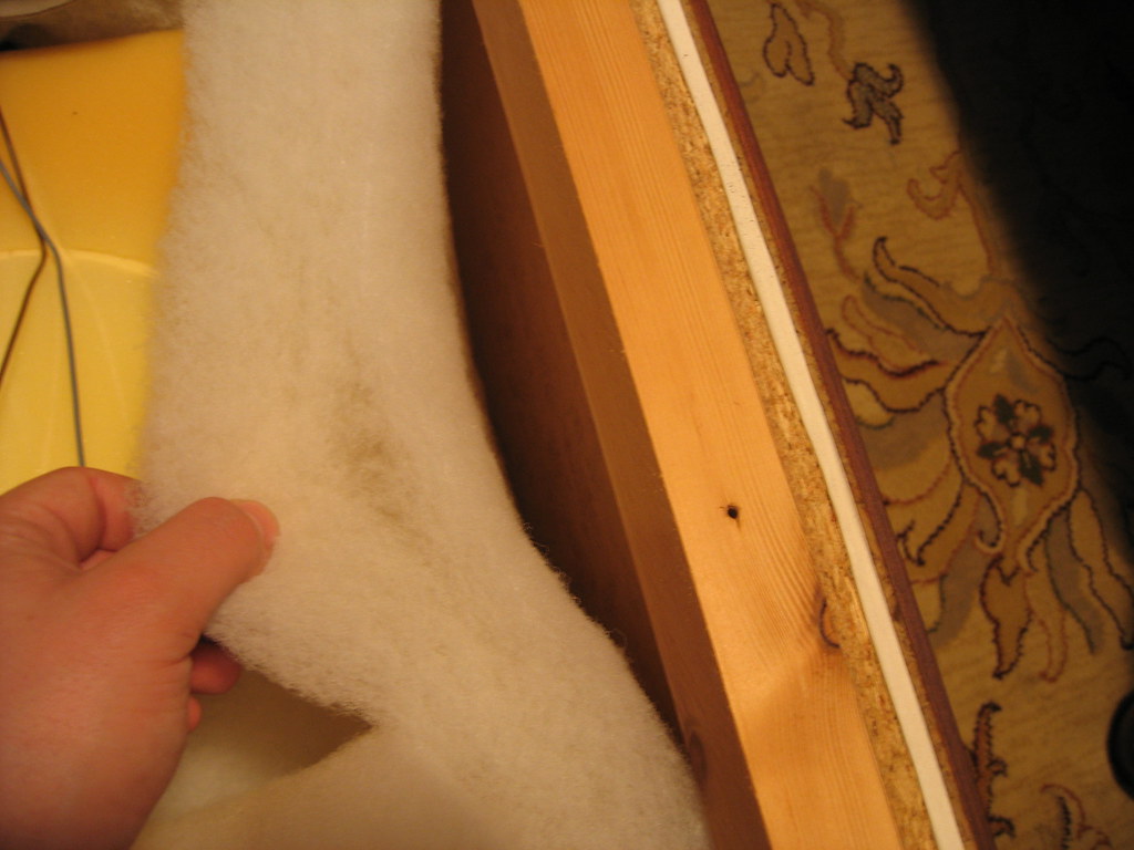

The crossover seems rather sophisticated, and the drivers are indeed well made. The sub has a small magnet and is stamped steel.The LF woofer is cast with a huge magnet and a poly cone.
The cabinet doesnt seem braced, but it is well built in my opinion. Isolating the drivers from the sub seems like a good idea as well.

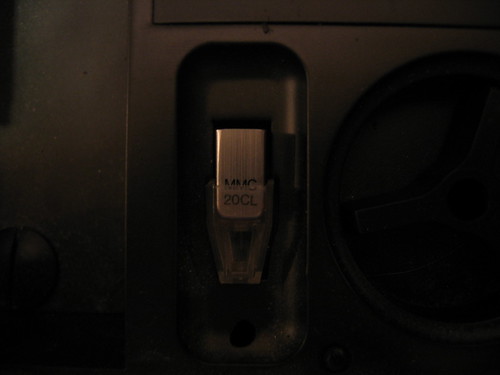

What about this cartridge ;)
Problem is, its got no diamond at the end of the stylus. It looks fine but wont track on a record, leading me to believe the diamond tip is missing.
Get ready for the sticker shock when you go to try to replace the missing needle. The replacement cartridge probably costs more than what you paid for the whole set up. I have had a B&O receiver and speakers for a while now, but was very lucky recently when I found two turntables to go with them. Both styli are intact and in perfect condition. One turntable has linear tracking, but the other has a standard tonearm. I must admit I was initially attracted to the Bang & Olufsen for the styling of the pieces. The whole 70's sleek design goes with my mid-century Danish decor. But I was pleasantly surprised by the sound and operation. You found yourself a very nice set up there. Good luck with it.

anybody have experience with that place? I would probably start with the 150 dollar cartridge just to play with the table and get it working. Then if its worth it, id definitely replace the mmc20cl with another one.
Du-uude. ...the 20CL was their top-of-the-line. I believe a sapphire cantaliever Pramanik cut (hyper elliptyical) nude diamond stylus.. I've got a BG4002 if you need some place to store your 20CL:smoke:
The very end tip is missing on mine, at least I think since the thing doesnt track all that well. I'd be completely fine if my 20cl was intact, but i think its just eye candy for now :tears:
About the cartridge, PM me, I might be able to help. (I used to work in a B&O authorized service center)

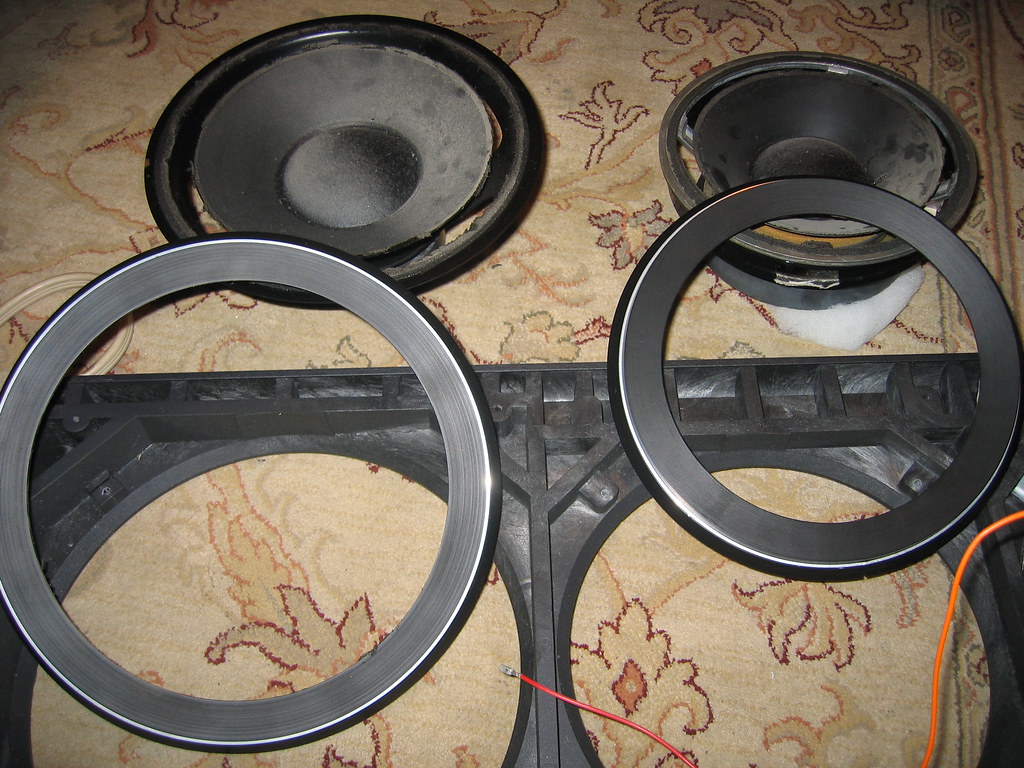

More nudies
Since you guys are making me feel great about my find, I decided to reward you all with more shots of these speakers that I am liking more and more. :D
Everything came apart rather easily. Any mis-conceptions I had that B&O was not thinking about ease of service and long life were quickly eliminated as I took these things apart without ANY difficulty. My only mishap was the negative terminal on the 10 inch driver decided to come off, but thats an easy solder fix. You can see where the red wire connects to the 10 inch, the negative one needs to be re-attached.
Instead of crappy paper speaker gaskets, B&O used these aluminum anodized rings with a rubber/silicone gasket on the inside that pressed against the drivers. These were a joy to work on.

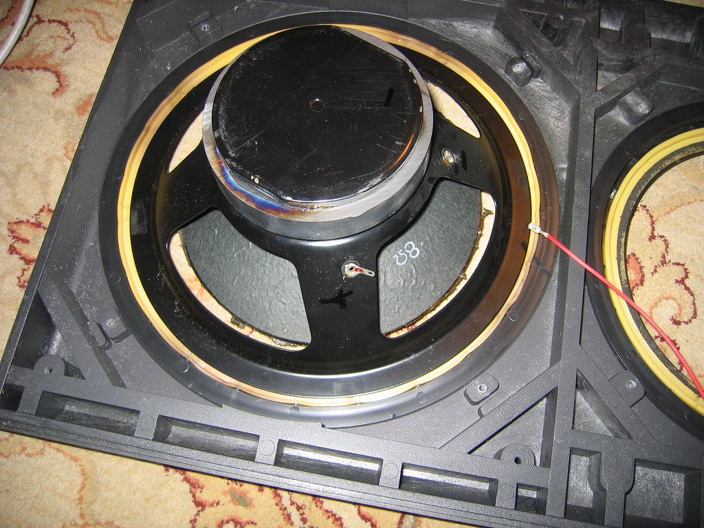

The resin panel the drivers mount to is very very sturdy. Here is the 10 inch driver, stamped basket, decent sized magnet, a better than average driver.

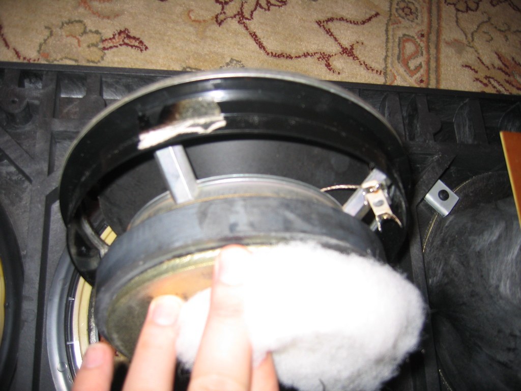

I was most impressed by the 8 inch driver. You say dynaudio was an OEM for B&O, well...these look like their style design. The magnet is HUGE, the basket is cast and machined aluminum, and the speaker is several pounds heavier than the 10 inch driver. The poly you see is actually filling a hole in the magnet, I have seen small holes before, but this ones about 3 inches in diameter. Is this for cooling, or what?
One last thing, I have never foamed a speaker before, and I am going to be doing a few other (16) drivers before I tackle these.All the other drivers seemed easy to find their centers where there was no rubbing, these B&O ones have way tighter tolerances than the infinity, or CTS drivers I have played with. Should I send these to a pro, any recommendations that will not cut the dustcap? The more good I hear about these speakers, the more intimidating the job gets!
