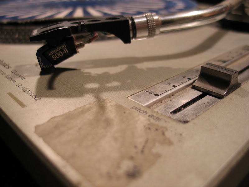

They were bought off of a local CL. They look like they were used BEFORE the current owner got them. They are borderline basket cases. One of the tonearms is very loose and shot to heck. Busted tonearm rest.

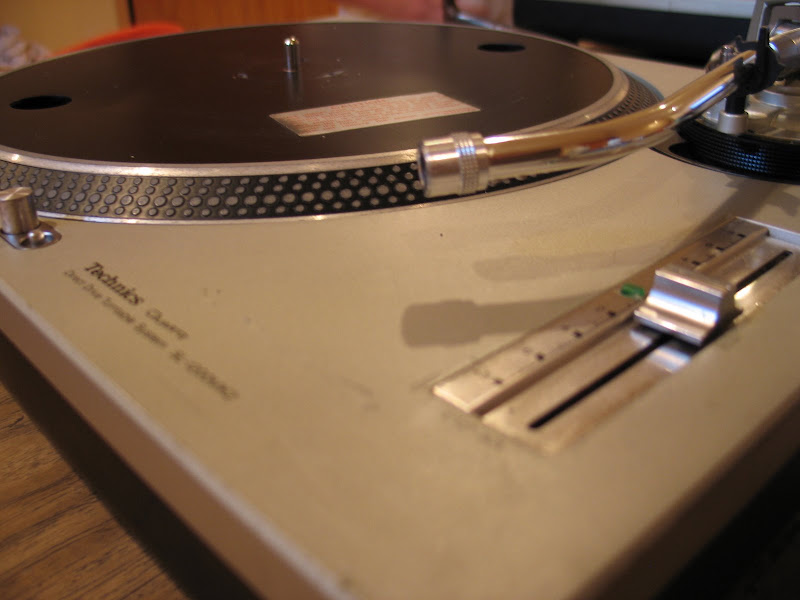

The other one is very cosmetically worn, tonearm seem operable at least, though it too has certainly seen better days.

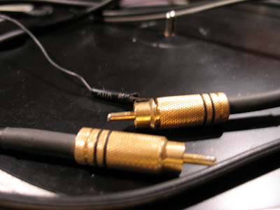

the IC's are upgraded with Hosa. All the feet are intact. And they still have the 45 adapters. All the lights work and the speed seems accurate on both of them. that's about all they have going for them!

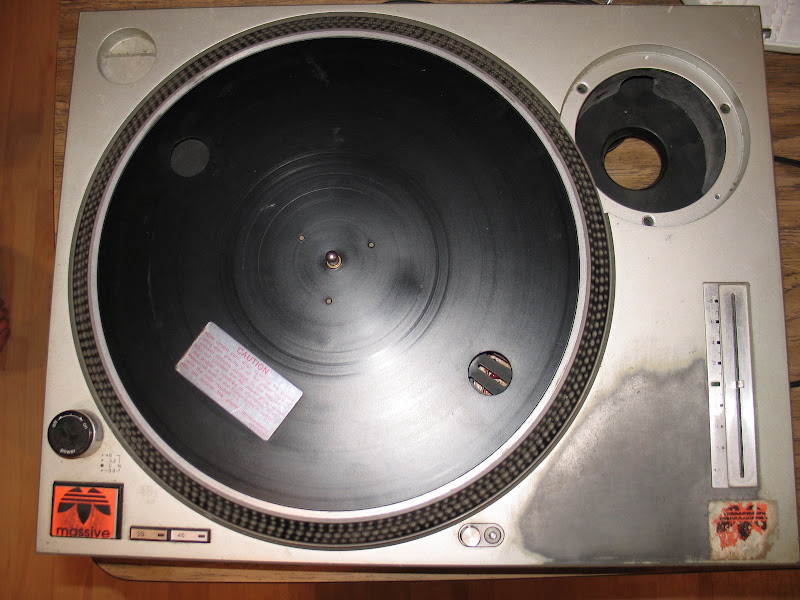

last night I decided that the one with the beat up tonearm is to be the "stock" 1200 because it doesn't have the serious wear on the plinth. So last night I disassembled it and started cleaning. This was my first time taking one of these apart, I have to say they are pretty darn slick! Easy to work on.
This morning I took the tonearm out of the "bad" one (I'm going to have to come up with a name for this one) and started to clean it up. I've found that the VTA adjustment is cranked all the way down past zero and I can't seem to get it loose. I'm not sure but I think at one time it had it's "rum and coke collector" filled and that dried up gunk in combination with it's being cranked all the way down is causing the problem. Right now I've got some isopropyl alcohol soaking in the rum and coke collector to see if it will get it to loosen up a little.

My goal is to at least get it up and running this weekend and spinning vinyl. I'm almost there already actually, I got the VTA unstuck and installed the thing into the stock unit. I stopped putting the deck together when I realized I didn't even know where to put spindle oil (which I haven't gone out to get yet) and thought I could end up having to take it all apart again.

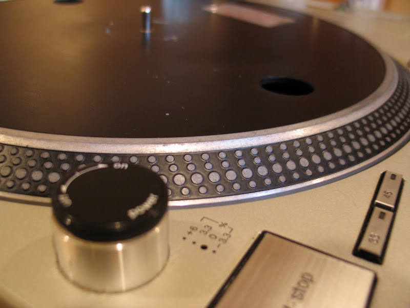

How do you get the strobe band on the platter looking good? It seems to me that anything that will "fix" the silver dots will destroy the black paint and visa/versa.

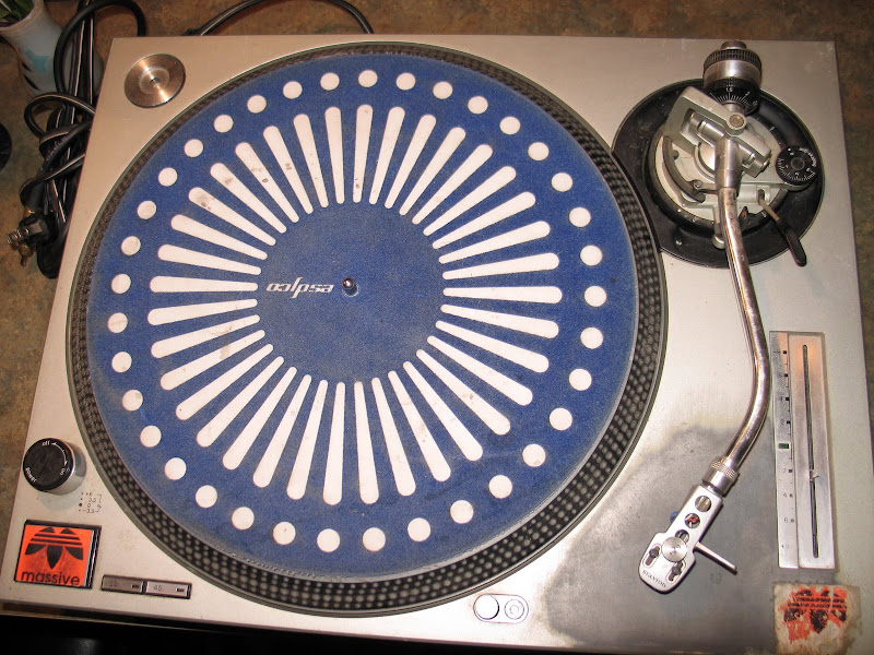

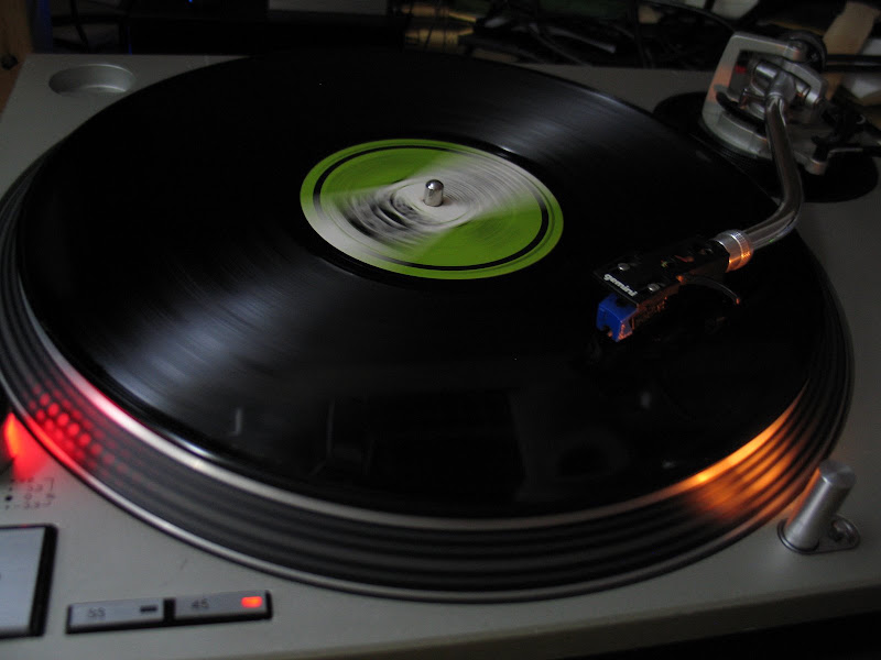

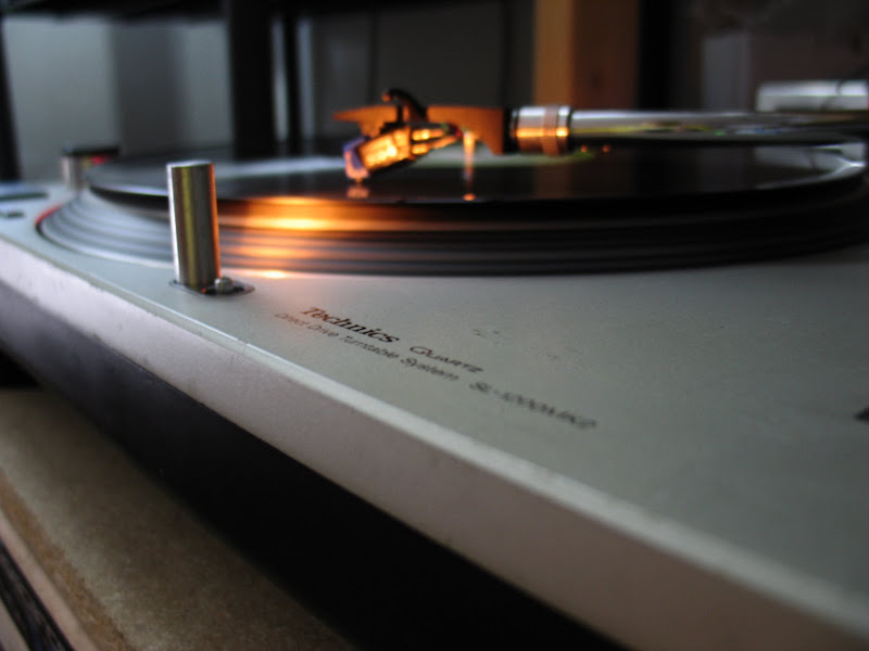

The Stock unit cleaned up and spinning.
I'm just using one of the DJ carts that came with right now on some sacrificial vinyl while I sort out my 1229Q that has my "good" cart/stylus (M95ED w/ Jico SAS)

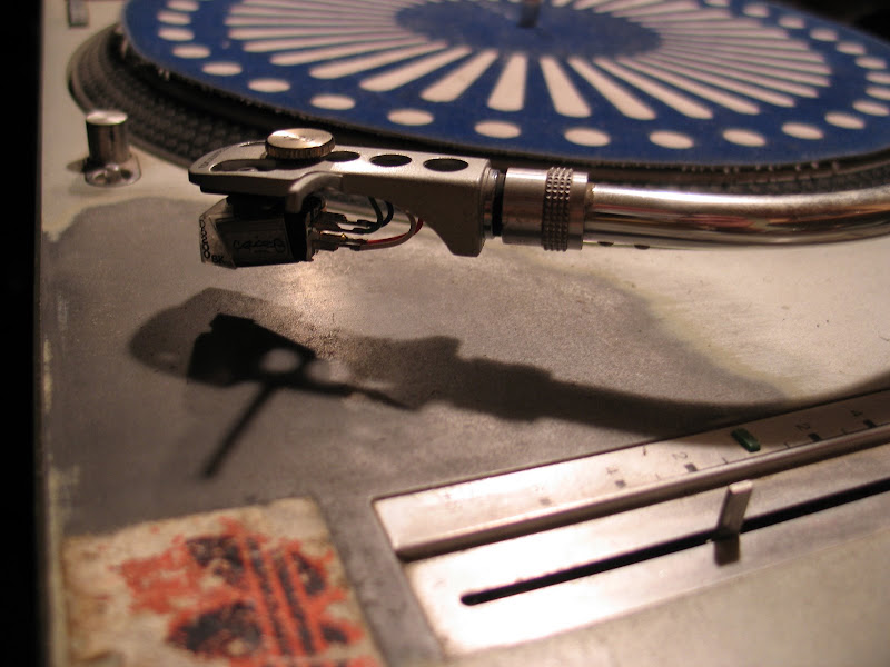

The MKE in it's beginning state.
Yeah, it's ok right now. I'm looking forward to putting the Jico SAS on it and getting the alignment dialed in to see what that's like. But so far so good.
