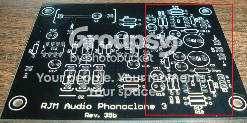

Here is one channel of the PCB's I bought, everything inside the red box is the super regulated power supply, it's the majority of the circuit. By using batteries we cut out all of those parts. The music part is on the left side of the red box. It's a very simple circuit but it works unbelievably well.
Why do you have 4, 1nf caps??
There is one per channel on the original schematic and PCB.
There is one in C1 and three in parallel in C2.
The original schematic has been updated a few times, this is the latest one I have, and the value of R7 has been changed to 68k since then, which is what I used.
R6 you can see is now 768k and not 750k as in the original parts list to accommodate the change in C2 from 2.9nf to 3.0nf for the RIAA section.

You did not go with the originally recommended .68nf+2.2nf. Wima has them in pulse film, 2.5%. Do you know why it was changed? 2.88nf is closer to the 2.90nf originally spec'ed for the RIAA curve.

See my edit above about R6 which was changed to bring it back in line. You can see how simple this design is.
