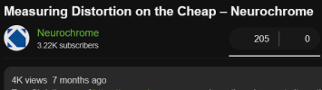

Screenshot 2025-08-11 at 17-42-57 Measuring Distortion on the Cheap – Neurochrome - YouTube.png
youtube.com/watch?v=0lc9ramAufY
useful comparison video in regards to measurement hardware shopping and software interface usability.
