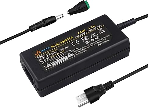

Hopefully this is simple. I'm putting together a simple system in my workshop, and need a slim sub to go beneath or behind my bench. I happened to have an under-seat 8" powered sub from my previous vehicle - so I thought I'd just use it instead of buying something new.
The remote power feature can be disabled, so I assume that a 12v DC benchtop power supply with an on/off switch would be the thing to get. I'm just not sure about the amperage. The manual for the sub gives me peak and rms ratings (600w & 150w respectively), and there's a 20 amp fuse built in. But I can't seem to find any info on how much actual power it draws.
A quick search brought up several DC power supplies for work bench use that seem to range from 2.5 - 30 amps. If I'm going to have to go top of the line with one of these I'm looking at the $140-$150 neighborhood. I only paid $100 for this sub, and I can buy a new slim profile model for in home use for $100-$150. Just trying to be reasonable about the math.
Any advice from the local engineers? Can I get away with one of these 5 amp power supplies for $50?

I found sort of a beefed up 12v laptop adapter that was 20 amps for $40something. But that leaves me with no power switch. Pretty sure those ac switches that plug straight into the outlet tend to max out at 15 amps, which means I'd have to install a heavy duty inline switch. Simple job - but worth the effort? I'm undecided.
I did find one 13.8v 30 amp model with a power switch for $70. I'm thinking it might be worth it to just go that route and be done with it.
I use a 12v computer monitor brick to power an HDFM auto head here. Just had to modify the plug. Mine is rated for 6 amps DC, so check the requirements on your sub first. Cost you maybe $15. Whether it'd work for you or not depends on how hard you're planning to push it.
Get away with? Hmmm...it will play, sure, but you won't be able to get anywhere near the sub's capability with only 5A supply. So, sorta depends on your use case. Low levels may be fine, crank it up, twist off the knob... nope.

I'm just pairing this sub with some bookshelf speakers, and I'm definitely not what you'd call a "bass-head". Just enough to fill out the bottom. So I'll certainly not be pushing this to its upper limits. When I think about it though - it only makes sense to get the component that's most appropriate for the equipment. So the power supply should push at least 20 amps (just based on fuse in the subs power amp). Who knows what else I may want to use it for down the road anyway.
The more feedback I get here the more I'd love to tinker with something diy. The PC psu is a really interesting idea. But I've got a lot on my plate right now, and need something "plug-and-play" so to speak. $70 is a tad more than I wanted to spend, but it sounds like the most reasonable, hassle-free option at this point.

Well I've run into another issue. This was supposed to be a simple project to get me up and running, but it's sure starting to spiral...
Apparently this sub is stuck in "auto-on" mode. The unit was not powering up when I hooked it up to my new 12v converter. So I took it out to my truck and wired up the + & - from one of the amps under my seat. Still nothing. As a last effort I plugged in the remote wire, and (after turning the key) it finally powered on. Then shut off after taking the key out.
So it seems that I need to figure out how to send "at least 3v" (according to the manual) to the center connection between + $ -. Anyone have any ideas as to how I might best accomplish that? The fact that the manual specifies "at least 3v" makes me wonder how much leeway I have. Could I get away with just a jumper wire from the +12v terminal? Or do I need to rig up a 3v connection from a seperate adapter on its own outlet.
