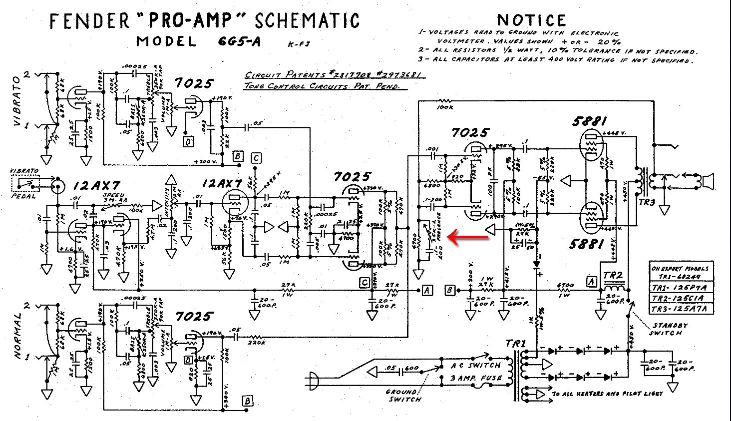

My 1962 Fender Pro has an adjustable feedback circuit (via a variable resistor and fixed cap network). Fender called it a PRESENCE control. It does affect the mid-high response, a little. Not much really.
