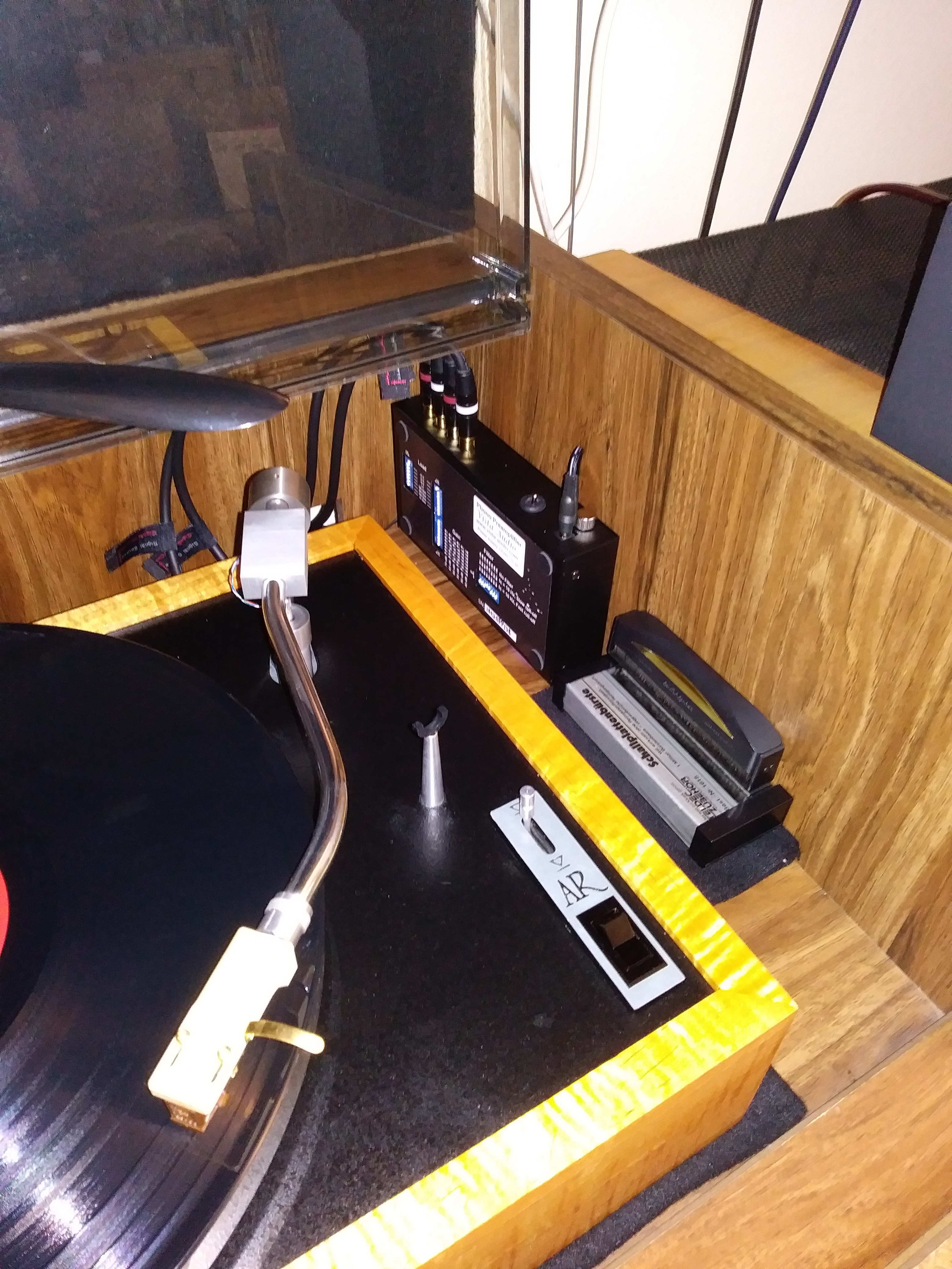

all this said, the AR XA has no anti-skate and is one of my favorite tables
The AR's have a mild form of antiskate manifested by the way the tonearm wires are dressed. When properly dressed as shown in the photo there is a low level antiskate force imparted to the tonearm. I can actually feel the resistance in tonearm movement when moving the tonearm by the finger lift.
