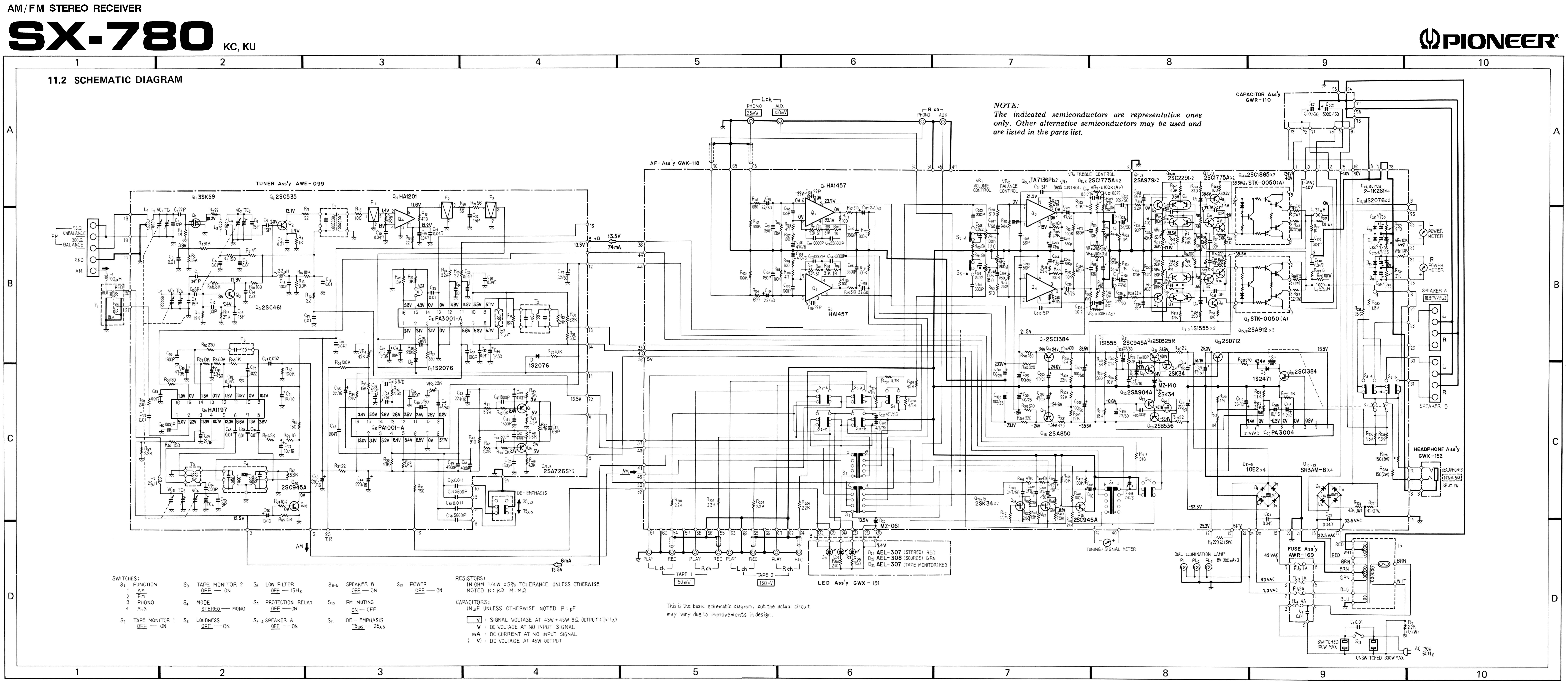

I know this has probably been gone over before but is there a very economical fix to this how much and what does it take?
2 problems: no sound from headphones or speakers and the far left light is burnt out....the fuses dont look burnt(if they are suppose to look like a burnt light bulb)
I cleaned thoroughly last night hoping that would do the trick :(
Please help with common issues and diagnosis if available.:scratch2:

If the panel lights function correctly that proves two fuses are good (2 & 4). If the tuning meter moves that MAY prove the other two fuses are good since there is some voltage at the tuner section. If the mode indicator lamps also operate that would be further evidence that the fuses are good.
It would still be best to verify the integrity of the fuses. The best way would be with an ohmmeter, and acquiring a low priced multimeter might not cost much more than set of potentially unnecessary replacement fuses. If you are thinking of replacing the fuses, you already have a Phillips screwdriver.
Your multimeter would be used to test AC and DC voltages at various point in the circuits. While you are out shopping for your meter (or borrowing one) you can start the download of the service manual from Here and get a copy of This Schematic.

One common problem is the voltage regulator solder joints go bad.
I've "fixed" them by fixing that problem.
I've seen bad caps on the relay.
There is probably a thread on how to check the voltages on the power modules. (BE SURE to do that carefully! IF you short the pins, you can blow the module. Cover the probe with het shrink or tape all the way except the very tip!).
MTF must have walked scores of folks through repairs on those.
the aforementioned voltage regulator solder joints are on the underside of the circuit board where the three 1/2 inch square power transistors mounted on shiny U shaped pieces of aluminum all in a row are mounted. They crack and open up.
PULL POWER PLUG OUT OF WALL before soldering them!

Ok Im getting a lil confused (over analyzing) ...How do I insulate the tip and what part do I test on the Darlington pack...still havent checked the fusesyet(2 of the light bulbs inside lightup when on the far left does not, there is no click either)....So I am at 2 ponts here; Test the fuses and test the voltage on the Darlington Packs....can you simplify this process for me its just not sinking in lol.... Thanks guys:thmbsp:
you can insulate the probe with electrical tape or wire shrink wrap ..all but the very tip so to minimise any shorting risk .
first test fuses ..if good proceed with the below ..if bad report back first with fuse number/s ..
meter set on 200v dc ..
power on the amp
black lead on metal chassis ."that is ground" red lead on pin 2 .expected -34v to -40v
black lead on metal chassis red lead on pin 9 expected +34 to +40v .
repeat for other power pack
report back with your readings .
