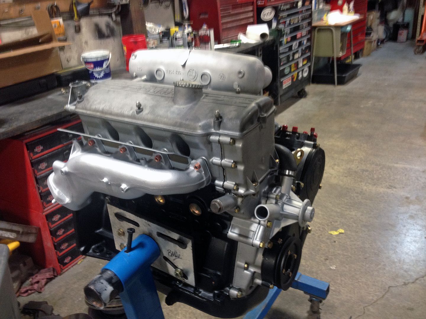

I have never had a car with this type of exhaust manifold mount. All the ones I have owned and worked on had a steel stud with a copper-coated nut.

I have never seen a broken or torn bolt from the cylinder head.
Mercedes w123, w126, w124 , G , Porsche 924, Audi, Renault 12 , 16. A few of the ones I've had the pleasure of working on. But nothing made in the USA.IMG_20210623_190910.jpg
probably less troublesome honestly. Not 100% what my BMW engine has but I think it could be studs. Its been together for 42 years so far as I can tell, and I'm not really motivated to change that unless I have no choice.
Mercedes w123, w126, w124 , G , Porsche 924, Audi, Renault 12 , 16. A few of the ones I've had the pleasure of working on. But nothing made in the USA.View attachment 3688091
Old BMW's, too.
