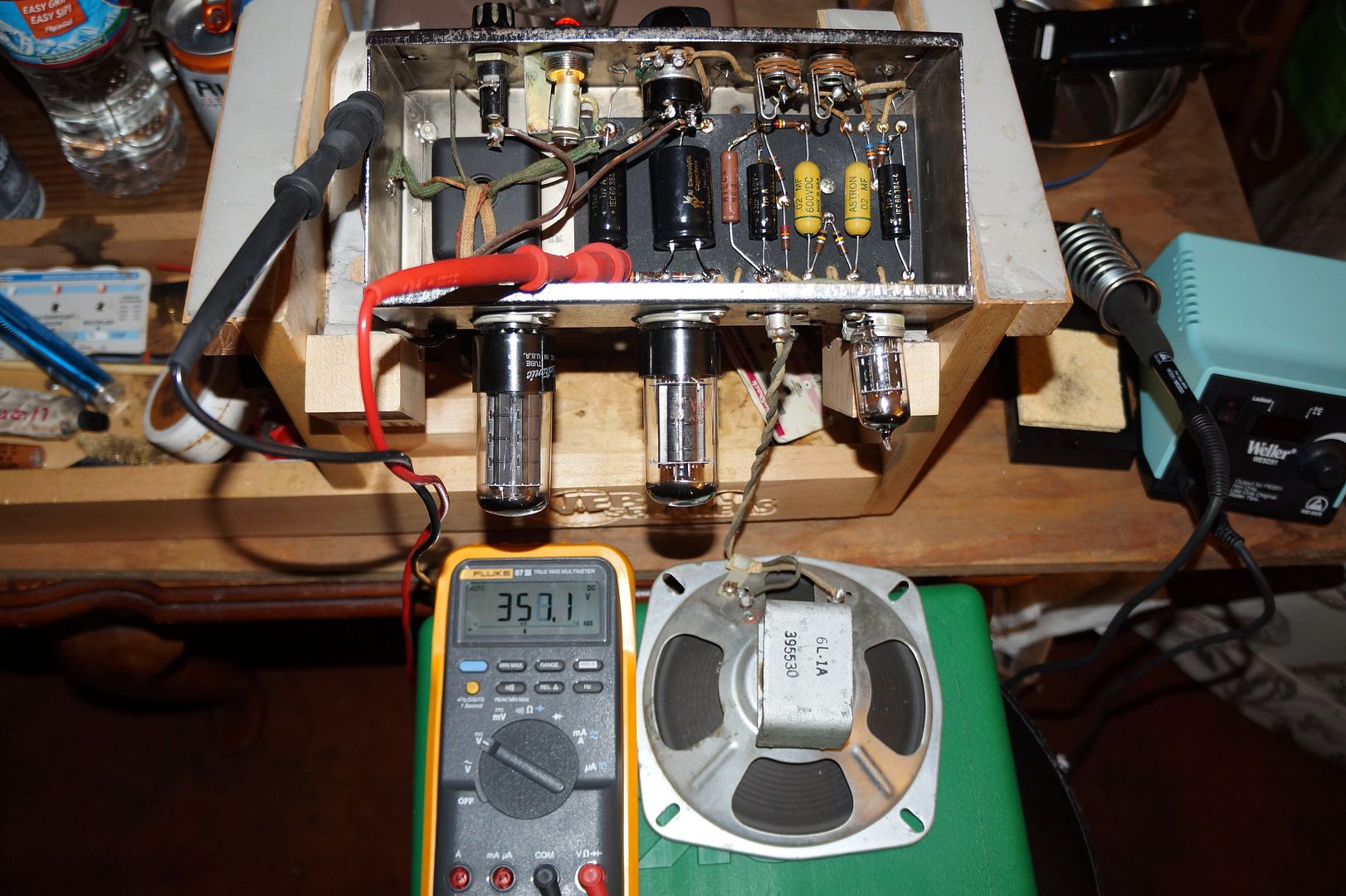

Hi,
I've completed another 5F2A. I used the Weber layout. It runs quiet. Sounds good and will sound better with a better speaker.
My question is on the B+ voltages. My house current is 121V. Pending the tube, (I've tried a couple) Pin 8 of the 6V6 reads
20 - 21.8V. The 16@450 caps are reading 388-390V. The 8&450 are reading 346V & 303V.
My understanding, which may or may not me correct is that those voltages are high and might be pushing the 6V6 to an early grave. I'd like to hear what ya'll think. Should I lower the B+ voltage -- can someone explain a way to do that? Or should I not worry?

Hi, without knowing your plate voltage, I can't know exactly what the output tube is dissipating, but roughly 44mA across your 470 ohm resistor
should be no problem if your plate V in 310 or under. Maybe Mr Boochie will concur, but I wouldn't worry...

Pending the tube, (I've tried a couple) Pin 8 of the 6V6 reads 20 - 21.8V. The 16@450 caps are reading 388-390V.
Hi! First off, does the 6V6GT show signs of red plating, or early volume onset of overdrive distortion? Is it running much hotter than other output tubes you are used to?
As miles2go asked, measure the VDC at pin #3 (anode plate), with the black lead to the chassis. I think 390 VDC is not the correct value. If it is that high, you may want to replace that Weber solid-state WY3GT with a tube 5Y3GT. The plate voltage should be closer to 340-360 VDC.
Let's say the plate voltage is 390 VDC and the cathode voltage across the 470-ohm resistor is 20 VDC.
Current draw across the resistor is (voltage) divided by (resistance). 20/470 = 0.042 amps = 42 mA.
Idle wattage = (voltage) times (current). 390 X 0.042 = 16.59 watts. That number is too high for a typical 6V6GT (max dissipation around 12-14 watts for Class "A").
Lowering the plate voltage will also reduce the voltage across the cathode resistor (the tube draws less current at a lower plate voltage).
So, say with a 5Y3GT tube, you get 340 plate volts and 17 volts across the cathode resistor. Now, the current draw is 36 mA, and the dissipated power is 12.3 watts, which is 90% of the maximum dissipation of a healthy 6V6GT, running in Class "A" mode.
BTW. If you do decide to try a 5Y3GT tube, use an NOS US-made one. They are relatively cheap and WAY better than any modern-made ones.

The B+ 390 VDC voltage of the Weber amp must be based on the solid-state WY3GT rectifier. It is a direct plug-in to the stock 5Y3GT socket. I have not seen a standard 5Y3GT amp supply B+ at 390 VDC — they are usually around 350-360 VDC. Of course, using a standard power transformer for a 6V6GT single-ended amp.
So, if this is the case, all he needs is to sub a 5Y3GT tube. It's worth a try. The 5Y3GT is prolly going to soften the tone. Small single-ended amps with solid-state rectification can sound sterile and compressed.
If the B+ is still too high, the PT must have PIV greater than the OEM tweed Champ or single-ended Princeton transformers.

Then, you could:
1.) Drop the B+ by adding a resistor between C2 and C9 (if this is a Weber Princeton clone amp).
2.) You can go to a larger cathode resistor (R8). Maybe try 600-ohms. I'd use a 5-watt resistor. :idea:
3.) Drop the resistance of the grid-to-ground resistor (R9) on the 6V6GT. From 220k-ohms to say 100k-ohms. I've found that you need to make significant changes to the G2G resistor to affect the idle bias.
4.) Run a bucking transformer.

Thanks for your reply.
Let me clarify that I didn't build a Weber kit. No Weber parts in this build. I just used their layout and schematic because I've done so in the past.
The PT is Mojo Classic Truetone I pulled from an older unit. And the OT is a new Heyboer. I use a 5Y3 not solid state rectifier.
That said, the measurements are:
@ 121 VAC the first B+ is 388. 6V6 pin 3 is 376. Pin 8 is 21.5v
@117 VAC the first B+ is 376. 6V6 pin 3 is 365. Pin 8 is 20.8v
@110 VAC the first B+ is 356. 6V6 pin 3 is 345. Pin 8 is 19.5v
@121 VAC the Heaters measure 6.8
Let me know what other info you need and thanks again.

What size resitor would you add between C2 & C9? and are you recommending all those steps together, or pick and choose?

From the diagram, a 10k-ohm resistor drops the voltage from 388 VDC to 346 VDC. "The 16@450 caps are reading 388-390V. The 8&450 are reading 346V & 303V."
That's a 42-volt drop. So, a 5k-ohm resistor between C2 and C9 should drop the voltage about 21 volts. Theoretically, dropping B+ from 388 to 367.
I'd use a 2-watt or larger metal-oxide resistor.

Thanks. That's easy. But how does it affect the sound?
