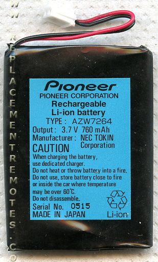

It is a rechargeable battery pack with a cable. It's cell elements are NEC TOKIN AZW7624 lithium ion.
It has a 2 wire cable with a connector on the end.
3.7 volts 760mAH is the key takeaway.

Yep that's the boy Mark ... exactly that. But finding one has proved impossible so far.
As Larry mentioned earlier, it's an option to open it up and see if there's any commonality but what I can see looks like a white rectangular plastic slab.

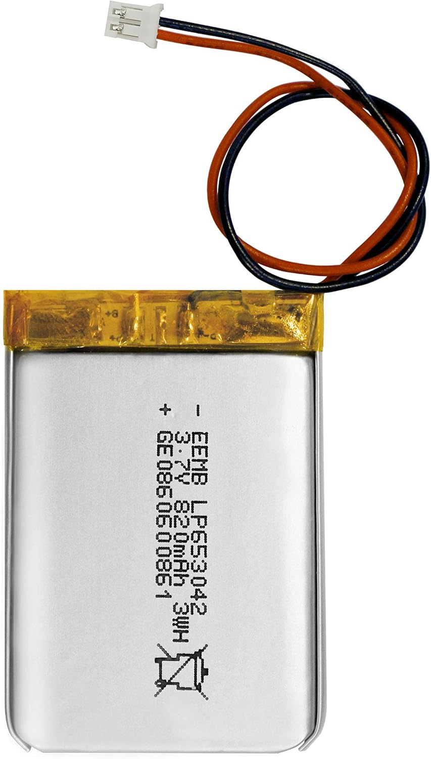

I just typed in 3.7v LiPo and it came up with a ton of stuff, some vendors list LWH in the description
Here's one for example- what are the dimensions for yours?

That's interesting. I had looked at Ebay (in fact my successful go to for most odd fit stuff) but only used straight product numbers. I'd not tried coming at it from a different angle as you have done there.
And indeed that looks very close the dimensions. Yeah going to approach it at that different angle. Nice suggestion

As ROLLCENTRE indicated, It is a 3.7v 760 mah Lion with 2 connectors. Any Lion with 2 connectors at 3.7v that would fit in the compartment will likely work if it has same connector. If not, cut the connector off that battery and solder it to the new one. The MAH rating only has to be close. I a low draw device such as a remote, mah in that kind of device is really only affects how long it operates before it needs recharging. Amazon and Ebay are filled with batteries that might work. If not, you are only out a few bucks. A NOS Pioneer will likely cost you several dozen dollars. A substitute may only be a few bucks shipped.
